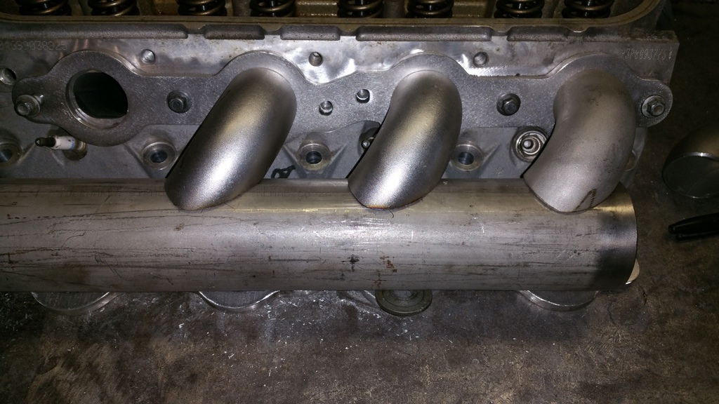

If you go this route get the long radius elbows, you will need the distance to make sure your elbows and log clear the sparkplug enough for access.

I appreciate the help. I was planning to use the long radius ones so it's good to know I was on the right track.
