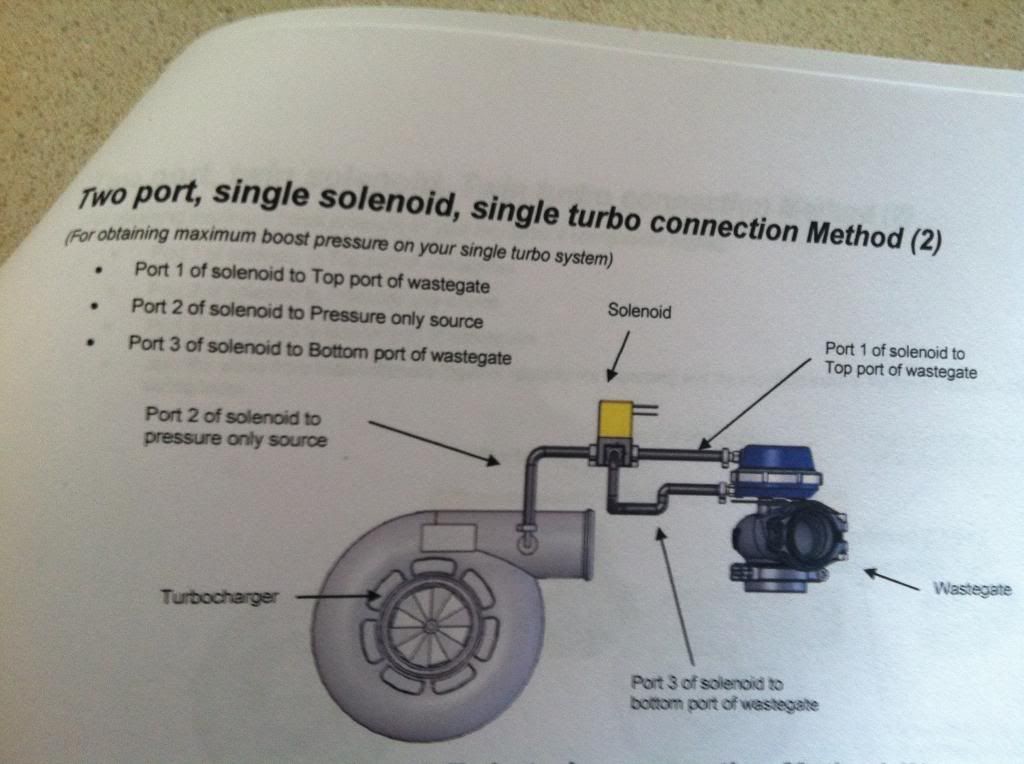

With the turbo he is using I doubt it...post a pic of the solenoid hooked up.

Originally Posted by smokeshow
Got a picture of the solenoid hooked up?
directions picture or my actual setup picture?

http://i775.photobucket.com/albums/y...ps3e66ea0c.jpg

Should work fine if its hooked up that way. Check the vacuum lines and wires.
