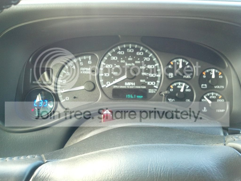

Also, any pics of where you mounted the display unit?

Ferocity, that mount is bad ***. I'd imagine you get used to looking the numbers sideways.
Any details on how you set that up, where you took the vacuu, hose out the firewall, etc?

Thats real clean!! Do you have any pics with the dash cover removed.

Yes I've gotten used to it. Honestly, my eyes are on the wideband most of the time in boost. Then afterwards I'll turn the **** two clicks to the left to see the peak boost. Adjusting the gate pressure, sensitivity, and RPM correction really will require you to log boost pressure.
Wideband location (pic shows my old Prosport wideband, sent it back for repairs, I have an AEM now, looks much better with the red numbers, matches the eBoost nicely): http://i869.photobucket.com/albums/a...pscce0bf30.jpg
The hose and wires are ran through the firewall on the far left under the dash where all the other wires come through. Same with the wideband wires.
No I don't but I can take some!
