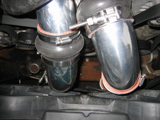

Linda, You have to run metal 90s or 45s. I had the same problem. Use a hump hose to connect.

I will only have one 90 that is silicone and with both pipes in the 90 it CANNOT collapse, now mind you the 90 that I have is different from others in its design.
Well, i thought the same thing......and i was very wrong. I had my tubes pushed all the way in until it was showing a buldge on the outside. I could not have got them into the 90 any further. It still sucked them in, bad. I wish i would have gotten a picture of it to show you. I am willing to bet that ANY 90* silicone coupling is going to collapse at 22" of vacuum. I am going to have to agree with JamesBond2509, I am going to have to use metal 90's...no other way around it, period. I am going to pick up some "cast" aluminum elbows. They have a very tight radius and i think i can make them work in place of the silicone ones. Looks like it will be a few more days until she is beatin the pavement again..... . Sure sounded good to hear her fire up though. The wait continues.......

Thats wierd, I was talking to Billy at TRT and he said he has never really found this to be a problem. My setup would actually have to tear the elbow apart to collapse, it is pysically impossible due to the size and the way it is setup with the piping. I think. I put the piping in it exaclty the way it would be run and it doesnt allow enough movement to actually collapse.
You may have a different situation than me, but the only way the elbow would not be able to collapse, is if the metal went completely through it. Otherwise, you would still be able to push in on the "elbow" part. Mine sucked in like i had a vacuum pump hooked to it. I actually pushed in on mine before starting it to see what it would be like if it did suck in some. When i pushed on it, i said to myself that even if it went in like this, it should still be okay. It went in twice as far when i started the engine as it did when i just pushed in on it. I hope yours does better than mine. In the long run, i will probably be better off with the aluminum elbows anyhow. Live and learn i guess.

okay, got some sleep and have cooled down a little. Found a place that sells "cast" aluminum 90's for $22 each, thats the cheapest i could find. Unfortunately, i can only use the tight 90's or it would be much easier to fix using the mandrel bent ones. Anyway, i am going to see if the place down here sells them today before i order them online (save some time). Almost forgot to mention yesterday because i was fuming....the bolt pattern on the Dmax fan is different than the 8.1L fan....so that settles that delema. I will have top pick up the Dmax clutch if i want to use the Dmax fan. I will keep you posted on the cast 90's and how they work out.

What about just sticking a wire coil through the elbows like they do in some tight radiator bends? At least it would keep it from collapsing on you.
Good enough for some testing maybe, I don't know where you would get it that size though. Maybe a Semi-Truck supply house.
