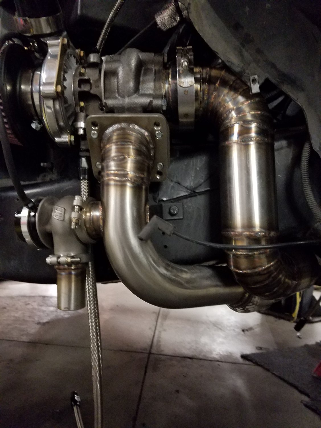

i use a mix of 7, 10 and 15* since im usually trying to squeeze tubes around tight areas. it looks a little goofier but it allows a little more flexibility in fitment. i also will cut a few different lengths so i can mix and match to get the tube where i want it.
We do use wire brushes and flap wheels to prep or metals.
We really like how much the pie cuts let you change the angles quick and easy plus fitment is key when you are building twin turbo kits for a wide array of vehicles like corvettes and camaros. We do have more room in the silverados and sierras but this helps us manipulate the DP for better fitment.

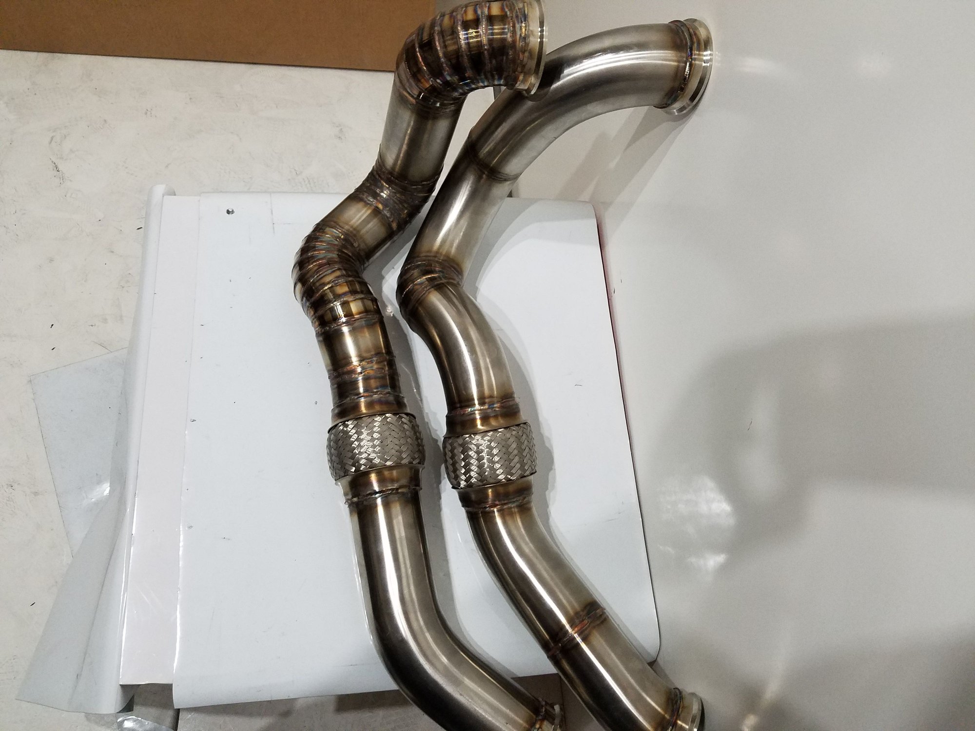

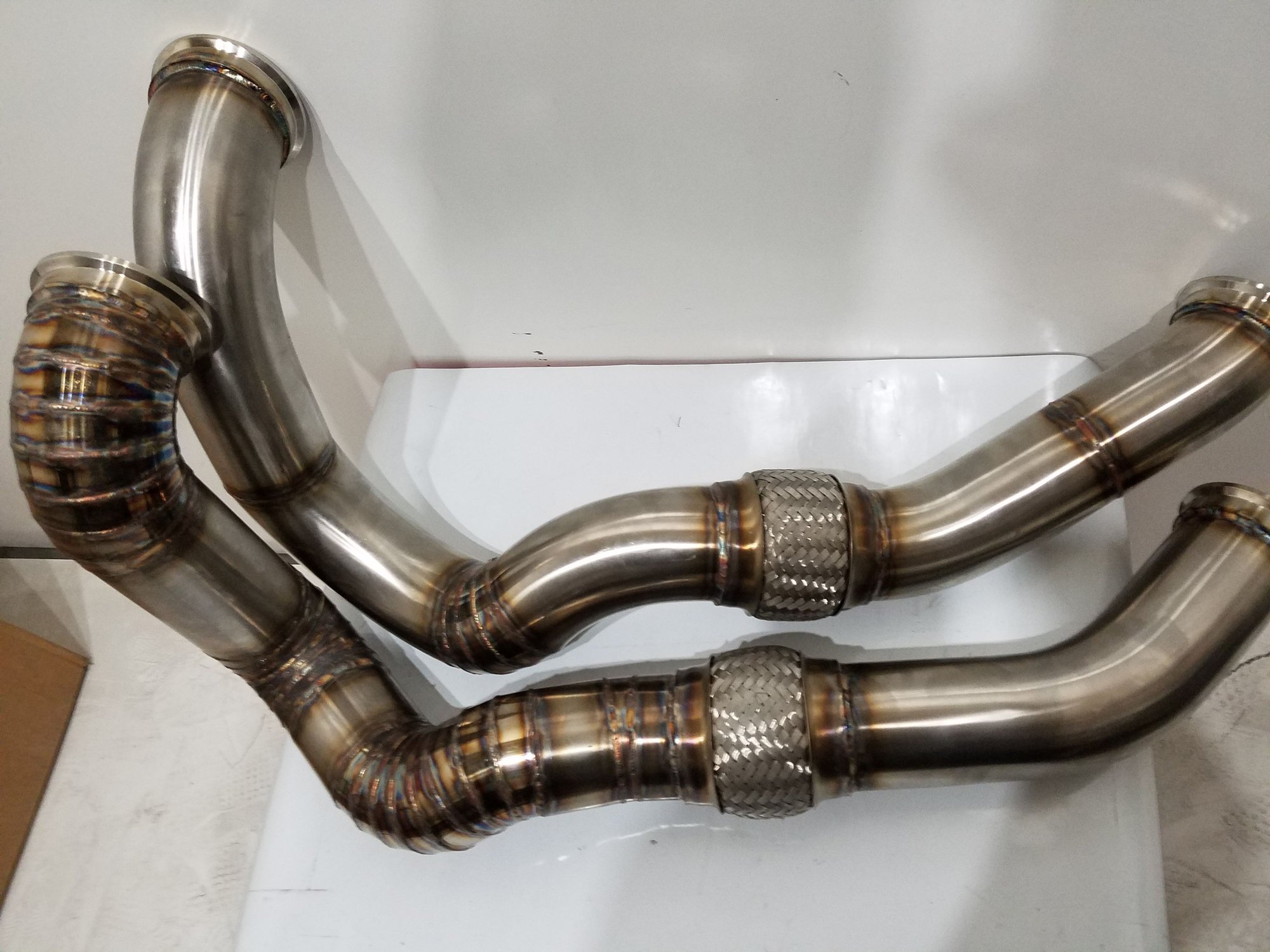

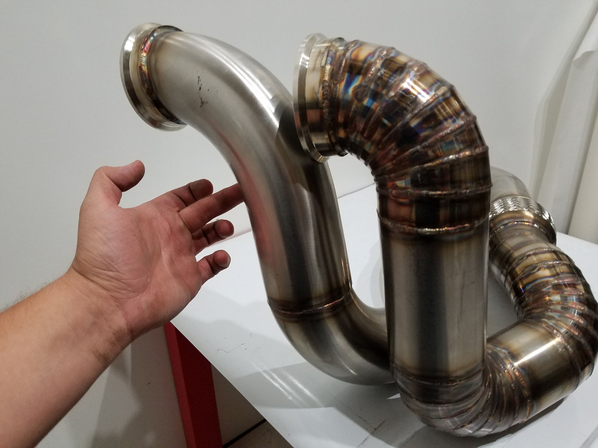

We use a band saw for must cutting but we also other saws if needed as well. So the pictures above show what our pipe used to be and then the DP with all the pie cuts is our new revision to the DP. These pipes are made for my C5 corvette twin turbo kit where fitment is a key player.
Horizontal band saw?
That looks great, you do some fine work. C5, talk about confined space. You have any shots of it installed?
Its amazing how much you can manipulate the tubing with a simple twist.

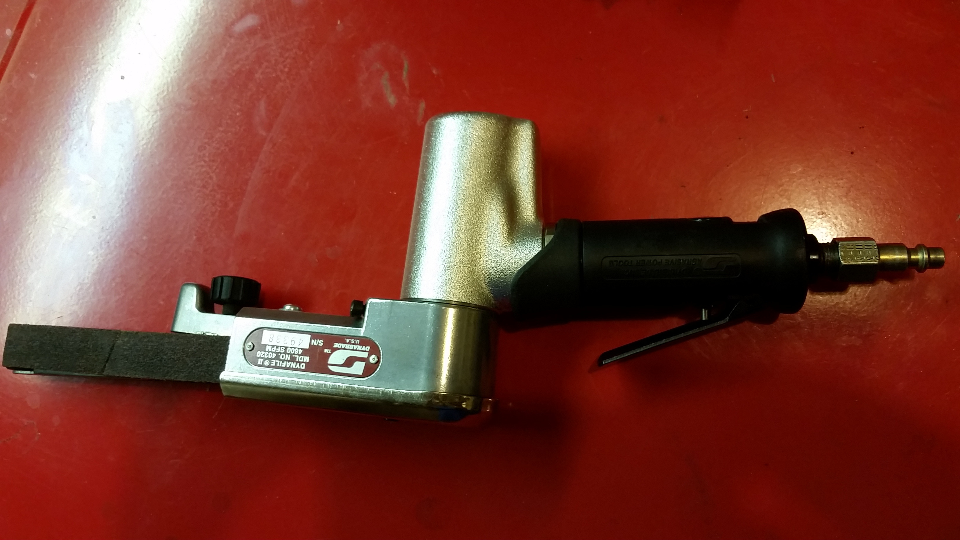

Dynafiles are handy tools, picked this one up used, cheap

We have put in 7 hour for each down pipe.
