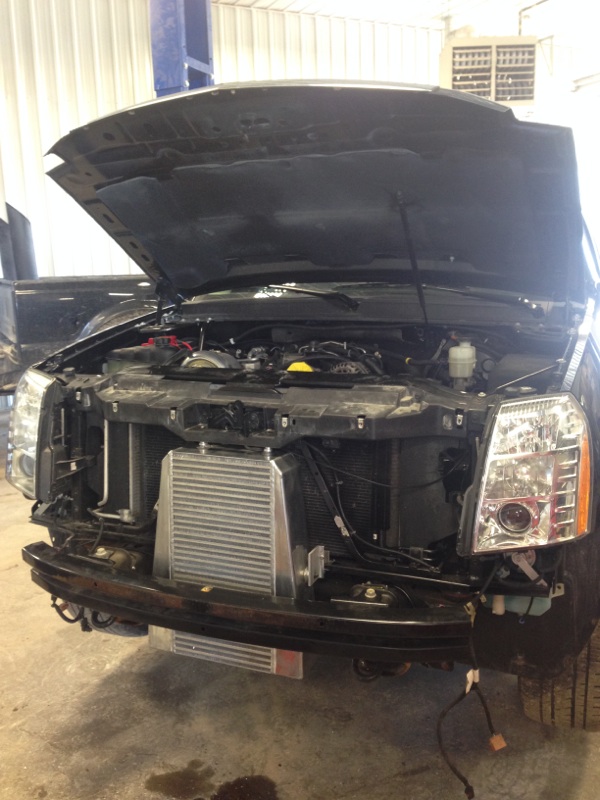

Here is a pic of mine from Trickturbo. 5" kit lots of room.

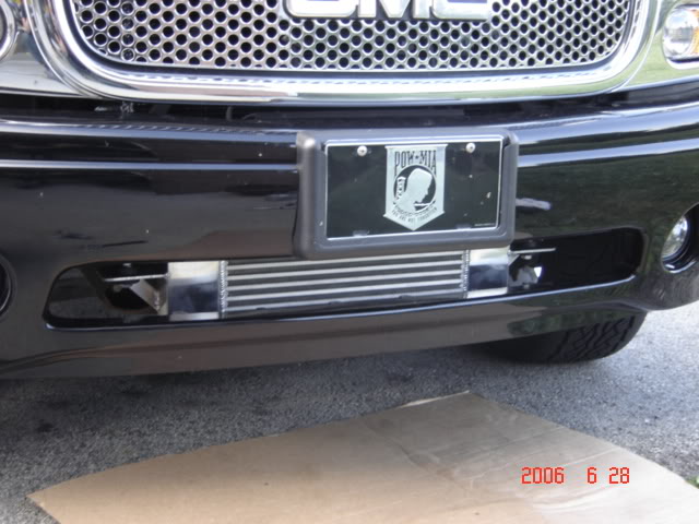

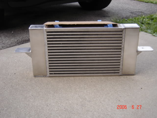

Kinda old picture but.
How well does that intercooler work with most of it covered by the bumper? Mine is in the same position and I'm wondering how much the function is inhibited.
Old Jan 21, 2015 | 05:57 PM
03sierraslt's Avatar
Posts: 19,007
Likes: 221
From: Western PA
My iat' were great with it there. The Denali opening is much larger then the regular sierra one.

Here's it standard
http://www.shop.trickperformanceprod...ll%20guide.pdf

If I have to choose one or the other I am mounting my trans cooler up high as if it's damaged your done.
Rick, is there room for a decent size trans cooler in that location with the intercooler?
OP- I am sure Rick could hook you up with whatever you need.
Old Jan 21, 2015 | 06:21 PM
TrickTurbo's Avatar
Truck Sponsor
Joined: Sep 2006
Posts: 4,466
Likes: 62
From: Wichita Falls Tx.
Yes depending on the grill and year.
Trans cooler can go anywhere in the air flow.
We have installed them infront of the ic.
We have also installed between ic and condenser.
Even down low.
Race car had one under the car with a fan.
We use to install the ic down low under the core support.
But like this way better.
99-06 Chevy no room to get around head lights with out major plastic cutting.
03-07 OBS tricky around the head lights but doable. Still will loose a good amount of plastic.
07-08 NBS good amount of room
09-13 lots of room no plastic lost. Just air dams.
14+ lots of cutting gonna be needed.
