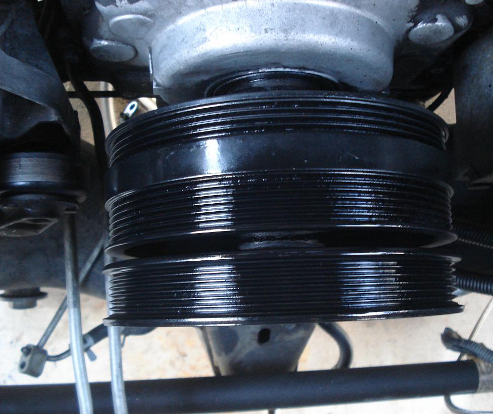

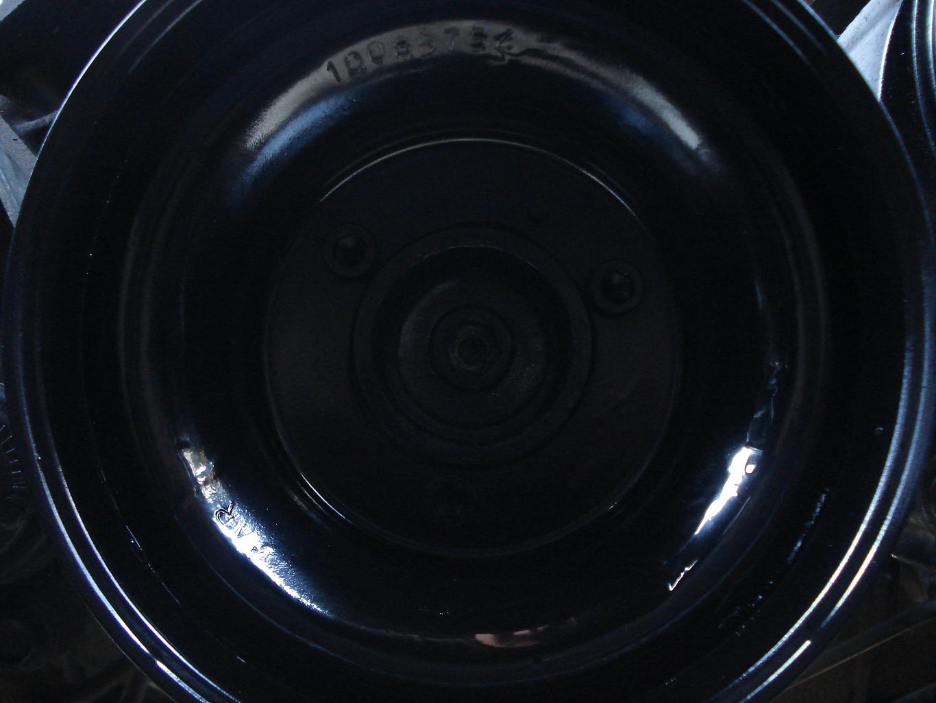

Heres a couple pics of the one i fabbed.Its a 350 vortec bolt on pulley to a spare cat hub.The hub has a flat back that sits on a 1/8" flat washer that is seated in the stock pulley.They are all pinned together.
that's a genius idea. i might use that for my blower setup

The dedicated blower belt really helps you get more out of a 6 rib belt.
