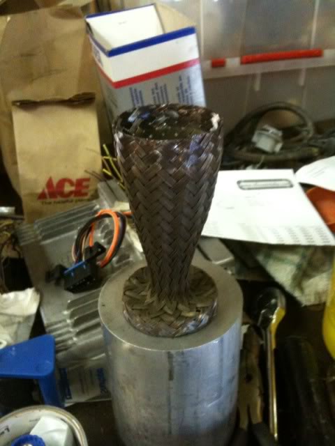

Looks nice! Don't want to be the bearer of bad news, but looks like the flex's you used have the "mesh" on the inside as well? I stopped using those on hots sides a long time ago because that mesh will come apart and it isn't pretty... Use Treadstones flexes with the flex tube type lining.

Ive saw that on a buddies build..got so bad it busted valve springs
This is why i wont use flexes

I like the frame prep that you did! Looks real clean, good luck with the rest of your build, stay away from those flex tubing's if you can.

Originally Posted by kbracing96
And the winner gets this one of kind trophy.
The turbo cup
