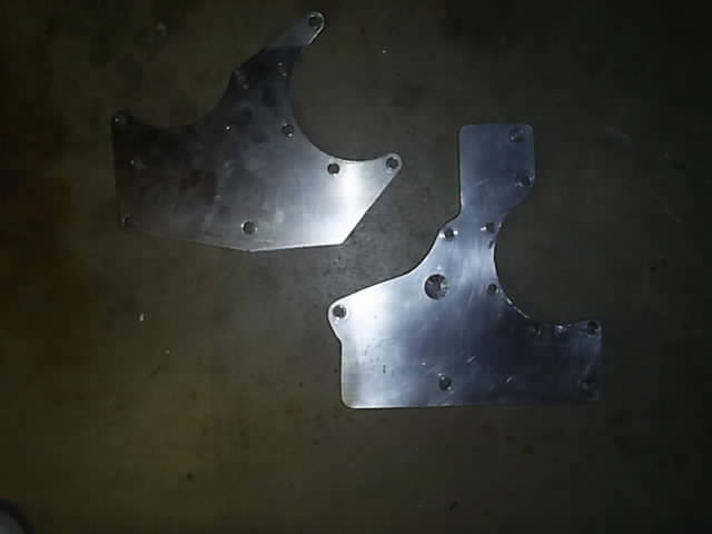

My Vortech came with a plate made of 1/4in steel. Amazingly, under torque it can flex enough to throw belts. Using it as a template, I made a plate of 1/2in aluminum with tabs to bracket top and bottom to the block. Now, it can't move. I advise doing similar.
The picture is a little dark but the left bracket is the kit and the right is the fabbed
