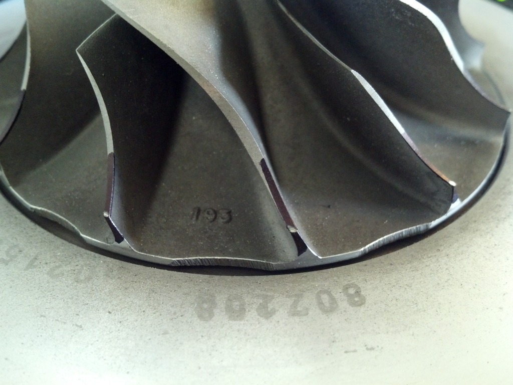

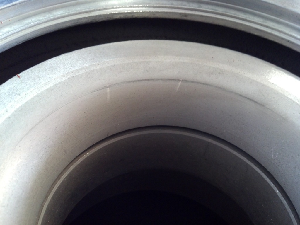

I marked the blades with black sharpie to see where they were rubbing. You can see they are rubbing on the very corners. 10 of the 12 blades show rubbing.

It rubs to the point of making it difficult to turn it. You can see there is about 140* or so of rubbing. Definitely NOT okay.
No matter how I clock it it rubs in the same spot. Even trying to force the housing to one side while tightening won't do anything. The o-ring is in there. Last resort would be to file down the compressor wheel at the corners slightly.
