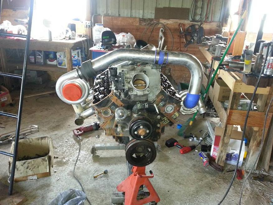

Old Jun 6, 2013 | 04:18 PM
whippled 8.1l build's Avatar
Joined: Apr 2012
Posts: 340
From: thurmont, maryland
yes i know its not pritty but it will work.. still making the driver side manifold.. plan on using the front part of the tubes for my waste gates once i order them. gonna do 50mm on each side. still thinking of a exhaust crossover to equalize pressure on both sides

So you have the compressors in series, but not the turbines..?

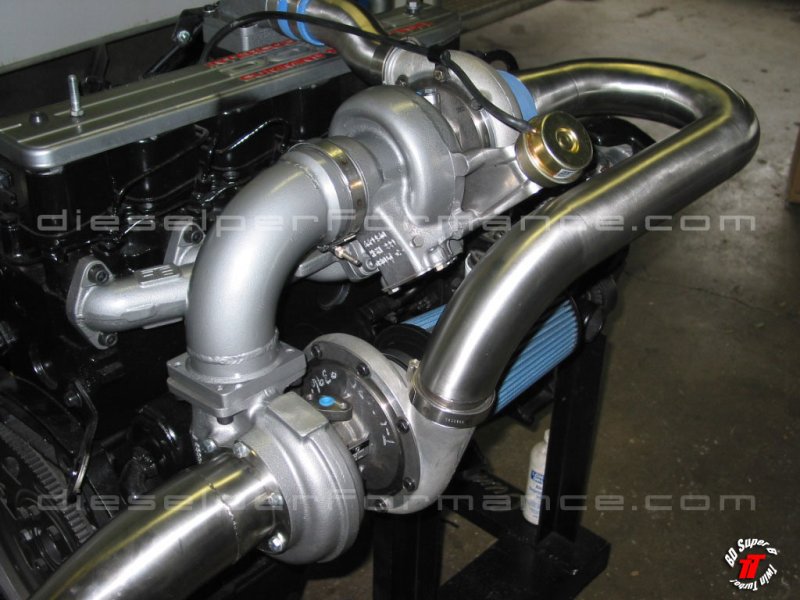

Kind of my thinking... This is generally how compounds are setup, a diesel I6 but still same concept.
