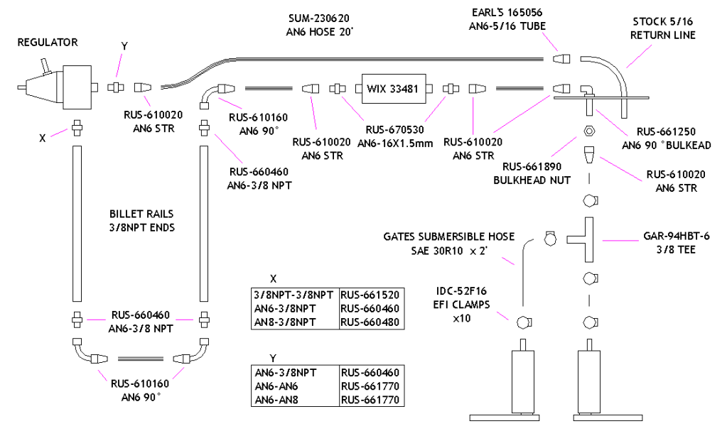

Ill guess Ill throw mine in...
This is for my 99. I have an 07 tank (bigger top opening), custom made stock bucket with 2 denso 1020 pumps and a -8 bulkhead fitting for the feed, I use the original 3/8" feed line as the return. -8 hose all the way to the rails and -6 return to the bucket from the regulator. Nasty performance billet rails, and FIC 80# (at 3 bar) injectors. The second fuel pump is set on a 2psi hobbs switch.
I havent had a chance to really push this system so I dont know what it will top out at. My guess is close to 1000rhp
