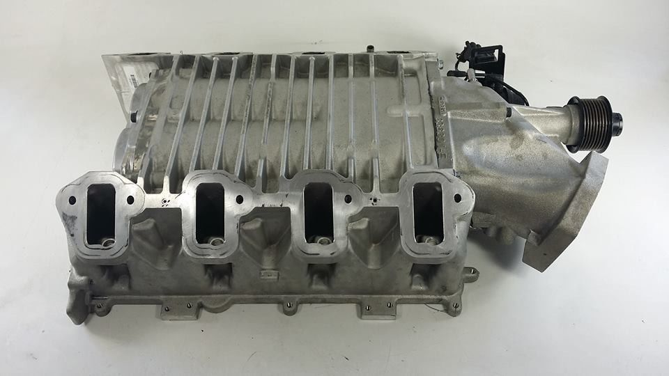

would a L92 CTSV SC fit on a truck eng ? would the pulley line up
with the truck pulleys ? would the Offset of the TB to the drivers side
clear the alt ? It has cathedral ports so it will bolt to my 799 heads.

I thought the LSAs had a LS3 style head thats rectangular port?

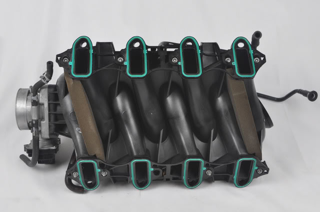

Yea that supercharger manifold won't fit in hour cathedral port heads

Default Ctsv sc
the ports look right to me, L92 not LS3
Those are rectangle ports... This is cathedral ports... They wont bolt up...

L92 is based on LS3 heads. Different castings is all, like 799 & 243.

The ports are way different, as is the bolt pattern. L92 and LS3 are the same port design(square port).
