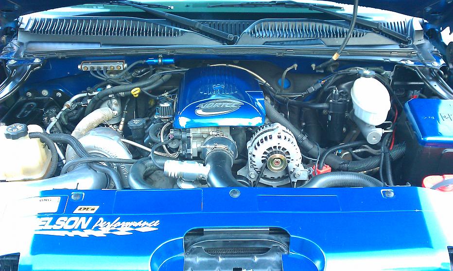

So I have been running my bov in the location where it is now for say a year and half with no issues. I am running it right before the throttle body "after" the maf. Is this wrong? My buddy comes by today and is checking out the truck, and sees where it is and says that it needs to be before the maf. I dont really see where it matters, it doesnt open till under boost when I let off the gas. Am I wrong. Nick...

i dont know for sure, but i think if youre running a MAF all the air that goes through the MAf needs to go into the motor, so you should either recirculate the air from the BOV back into the intake system or move the BOV, i think...

The purpose of the BOV is to vent off excess pressure that would cause compressor surge. So wouldn't you want it as close to the compressor as possible?

No you would want it as close as possible to the throttle body since thats whats restricting the air when you go from WOT to cruise.

Your friend is right, the blow off valve comes BEFORE the MAF. Otherwise metered air is not reaching your intake and it is going to dump fuel for a short while after you let off. Also in low load, high RPM situations the BOV opens, so you will be running very rich in that scenario as well.
So should I change it? I mean the truck runs pretty good. After I let out of it at wot it does richen up for a second then straightens it self out.

I would change it, yes. If for anything, for peace of mind that its running properly.

Well I plan on getting it dyno tuned here soon. and when this happens I will be going sd, so I will probally just let it ride till then.
