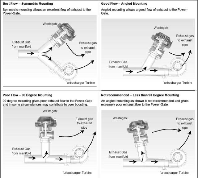

Old Jan 9, 2013 | 04:00 PM
M&M Turbochargers's Avatar
Joined: Jun 2011
Posts: 155
From: Rapid City South Dakota
maybe something to help you out
