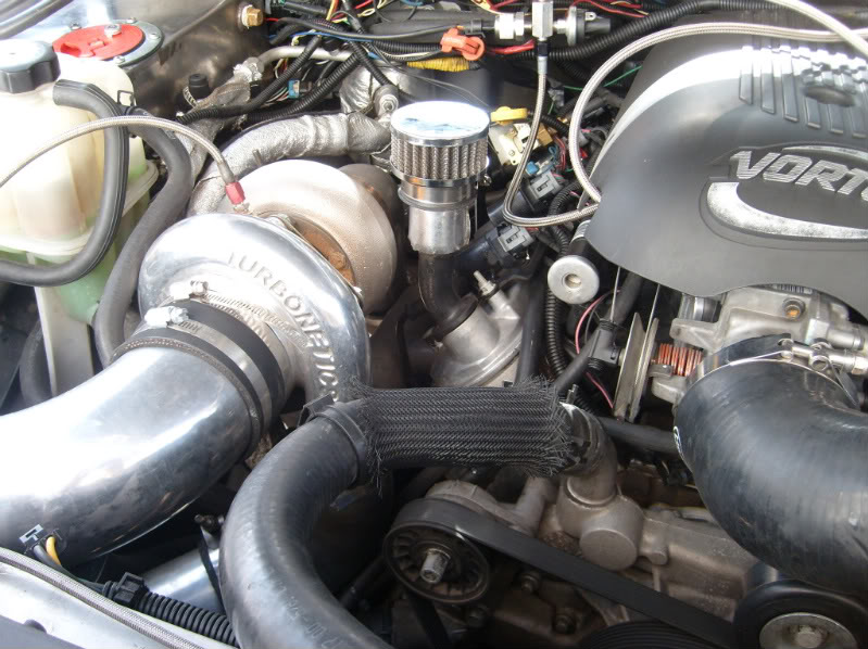

I think I solved my breathing problem. The hoses i have comming off the valve covers to catch can seem alittle small so I took an old oil cap, punched a 7/8 holes in the top and added a breather/filter from my pocket bike.

Do the leak down...My compression was within reason, but the leak down was what determined the ring were blown. Its a PITA, but better than guessing!
IMO, having a breather right next to the exhaust housing scares me. It is a great way to start a fire. I believe Chris has already been through that excercise. When under boost, even a healthy motor, there will be crank case pressure... in the form of oil mist. Just my $.02...
Bill

With the amount of oil I was losing before with the old motor, This doesn't make me nervous at all. I had to scrub all of my hot pipes with brake kleen and scotch bright before it went back on. Everytime i came to a stop smoke would come out from under the truck. LOL
