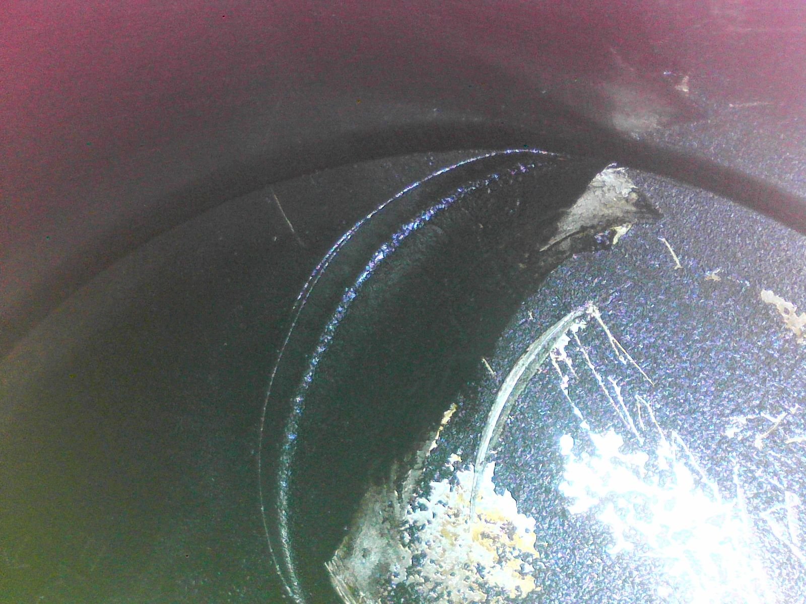

Its not a max effort build. Ifit was, it wouldnt have a blower lol. My original reaction was to fix these heads and have frankenstein, texas speed or craig gallant do port work while they’re off...but a little extra $ could put an after market casting up top and also speed up the repair (assuming i dont need a new piston$

I wouldnt fix it, Just get a new casting and and be done with it. Or pay the core charge on a used pair.
Similar issue happened to someone else I know just the other day. Stated when he did the head and cam swap he noticed the head's had some repair work like maybe it dropped a valve before.

replace the piston, or knock off the sharp edges with a rolec pad and let it rip?

You could probably clean that up and run it.

I'd be very tempted to clean that up and run it. Does it look like any material came off and ended up on/in the cylinder wall?

I would clean that up and run it.

Clean it up and run that bish...

stock bottoms for life. this motor would be a 6.0 or 6.2 if i originally built it. the 408 came with Annebelle (yes i named my cursed car after the cursed doll).
i'm not sure my OCD will let me slap it back togehter...It's probably comming out for 1 new piston. i'll re-use the rings from that hole to avoid honing.
