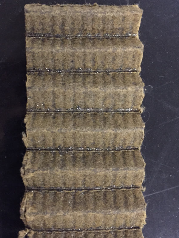

I don't know if I am higher hp or not. But I am having pretty low oil pressure when hot. For the first 1000 miles or so I was idling around 35-40 when hot. Now it is about 26-28 when hot at about 3k miles on the motor. Last oil change there was quite a bit of metal in the filter. I have 300 miles on this oil and I am going to cut open the filter this weekend. I think I have a bearing coming apart.

I have the melling high volume/high pressure pump. Cold start at 60psi. No noises. But scares me since it use to have 40psi hot idle pressure and now it has dropped. My pressure jumps right up to 40psi the second I touch the throttle. So that's good.
This was my filter from a few weeks ago.

How many oil changes was at the time of you cutting open the filter?

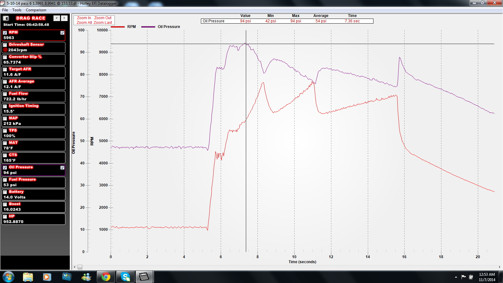

I run a 4" stroke iron lq (408") in my truck. Run a procharger and is likely over 1000 rwhp (never dyno'd it though). My rod/main clearance is 0.0027". I run the 10296 melling with the bad mother ****** spring in it. I run a serviceable Purepower oil filter and Royal Purple XPR 20w-50 oil.
At idle hot the pressure is 48-50 psi. On a 1/4 mile pass, oil pressure reaches around 95 psi at the top of first gear, drops to around 76-78 psi at the shift points (ls pumps are notorious for dropping pressure over 5500-6500 rpm). After the shift it comes back up and then falls again. The datalog screen shot below was after the truck had made several passes and the air temp was around 85*.
On the first pass of the day when the oil is coldest, it'll see 110-115 psi of oil pressure.
In the screen shot below, this is a datalog showing only rpm (red line) and oil pressure (purple line) and the Y-axis is shown for both.
