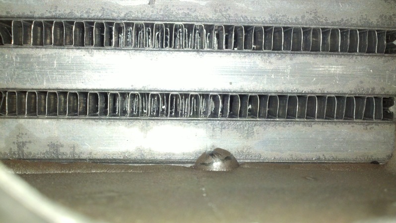

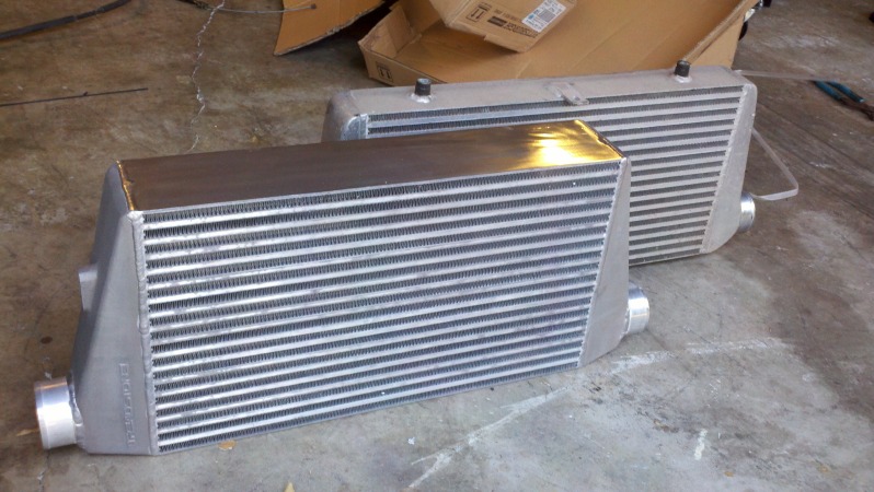

UPDATE!
Here is the new upgrade! No pressure drops or real test drives yet. It is storming now.
