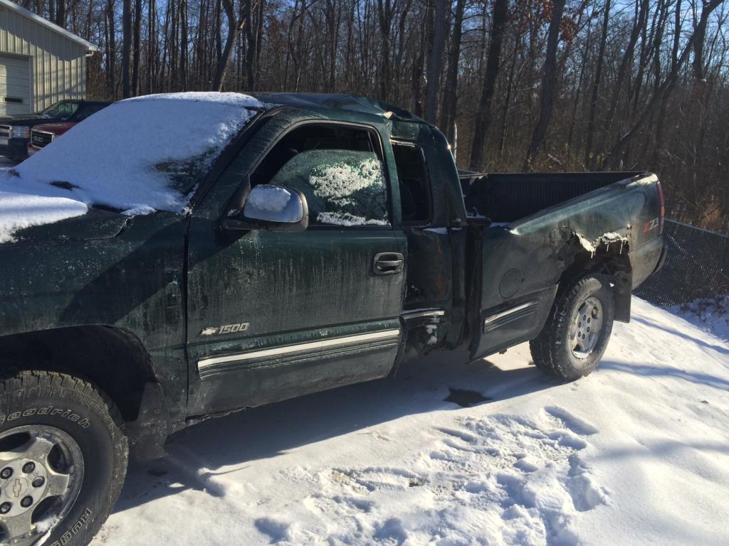

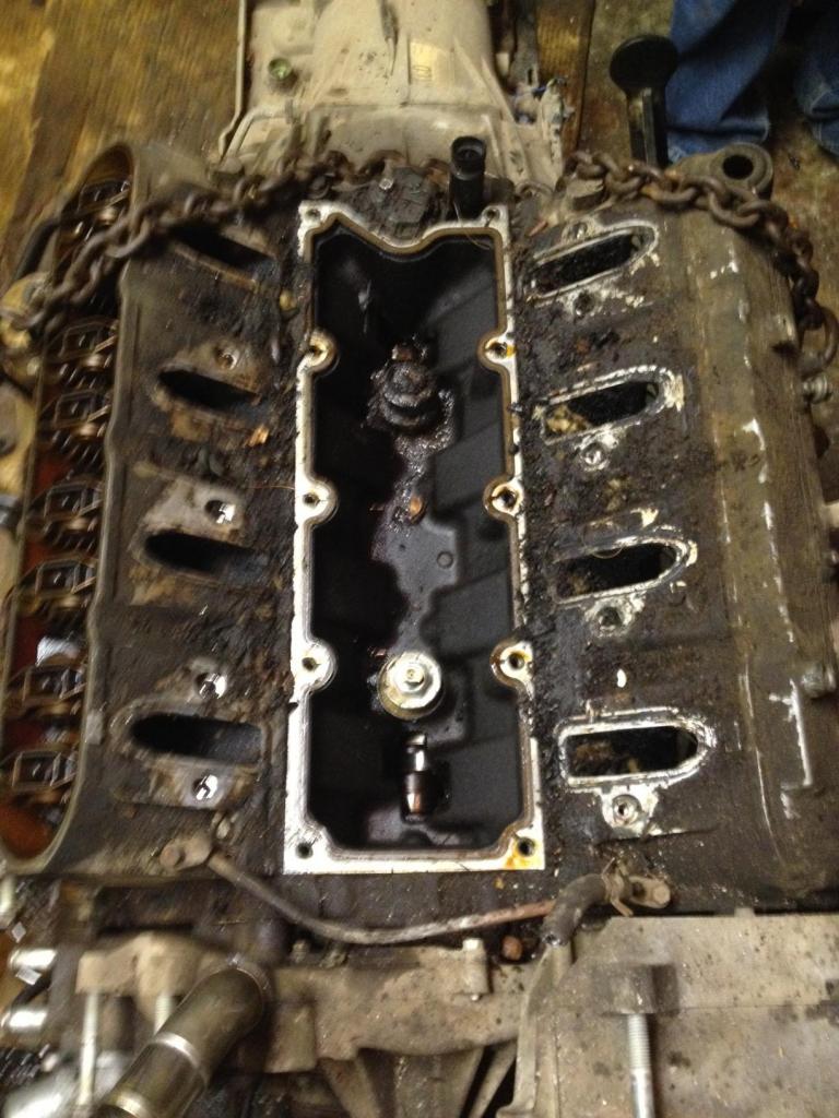

well sense this is my first post ill start by introducing myself. Im shayne, i live in michigan, im only 19 but you wouldnt guess it unless you met me, and my reason for being here is this stupid ls bug. id like to start by saying that i want any and all opinions on the build. the goal is about 750 whp with a single turbo in an ecsb/scsb cateye chevy truck, the truck will not be a daily driver, it will be a street/strip car but mostly strip and it will also be 4wd. i have pictures but i will put them in the thread below all of this but heres the plans for now. all things that are listed with ??? i need opinions here guys! as i get some help on those things i will edit this post.

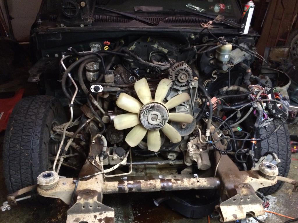

pulling the motor

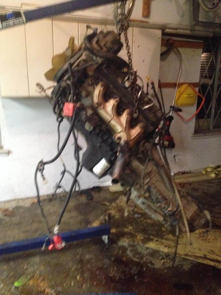

motor and trans pulled

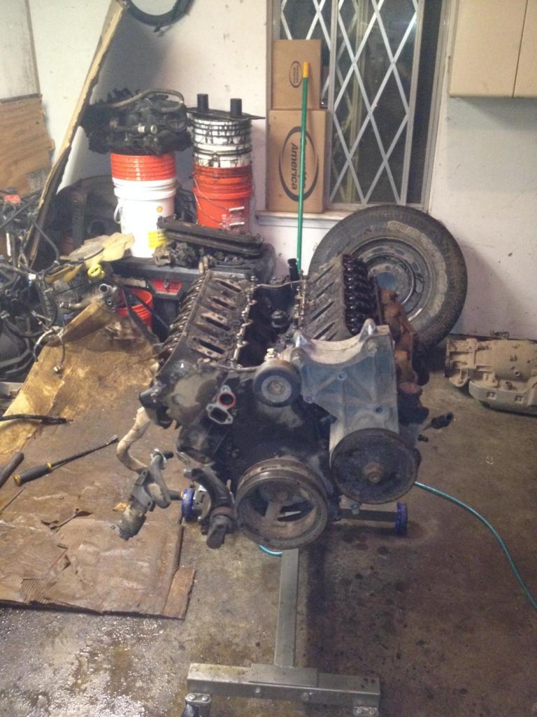

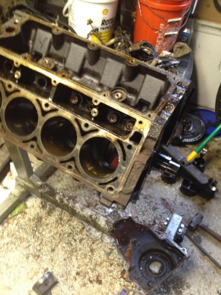

on the stand/partially taken apart

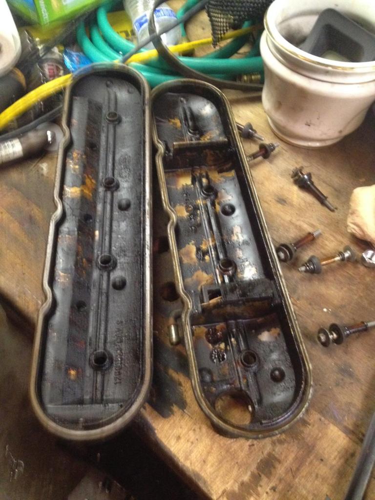

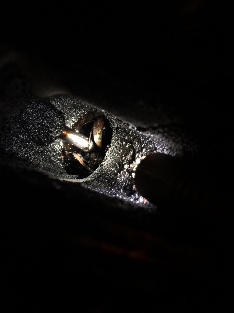

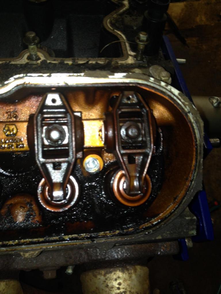

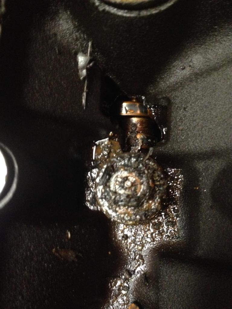

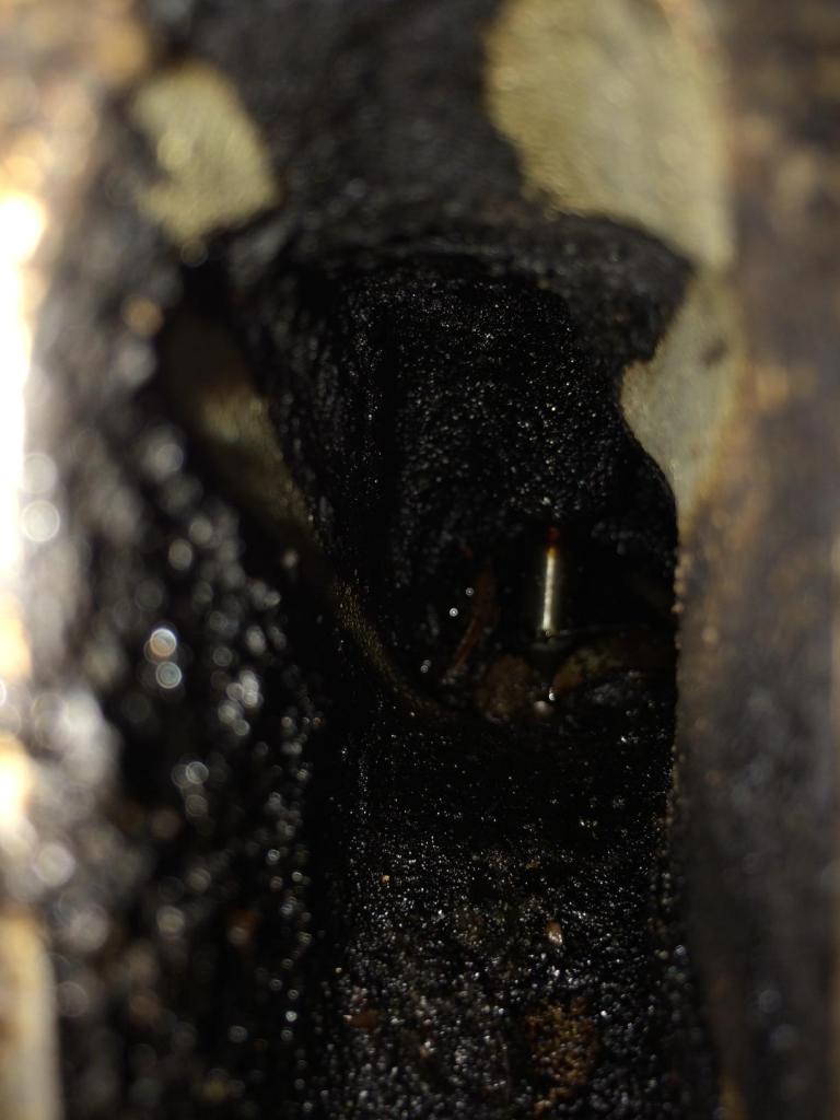

random pics to show how dirty it was

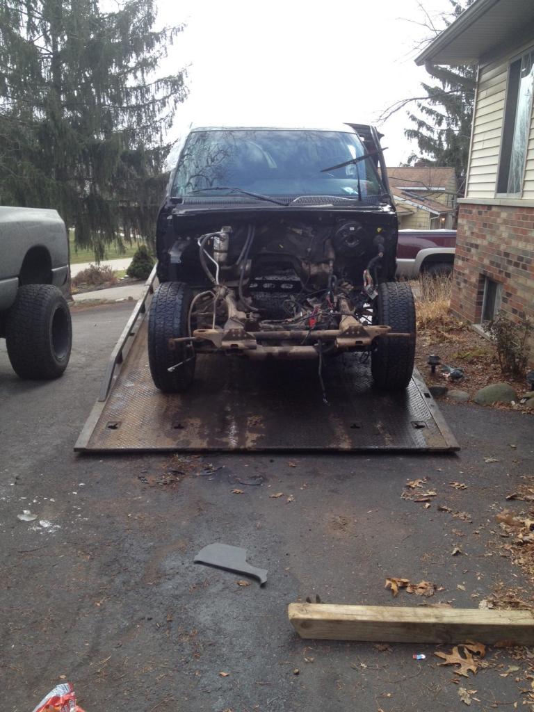

off to the scrap yard
completely torn down
thats all i have for now. i wont have anything back for a week or two but i will have parts coming in the mail so there will be updates!
