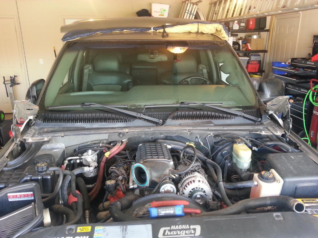

If you want a front drive, front inlet TVS2300 for a GM truck, you can either buy new or wait just a few days until I finish pulling mine off and save some money.
