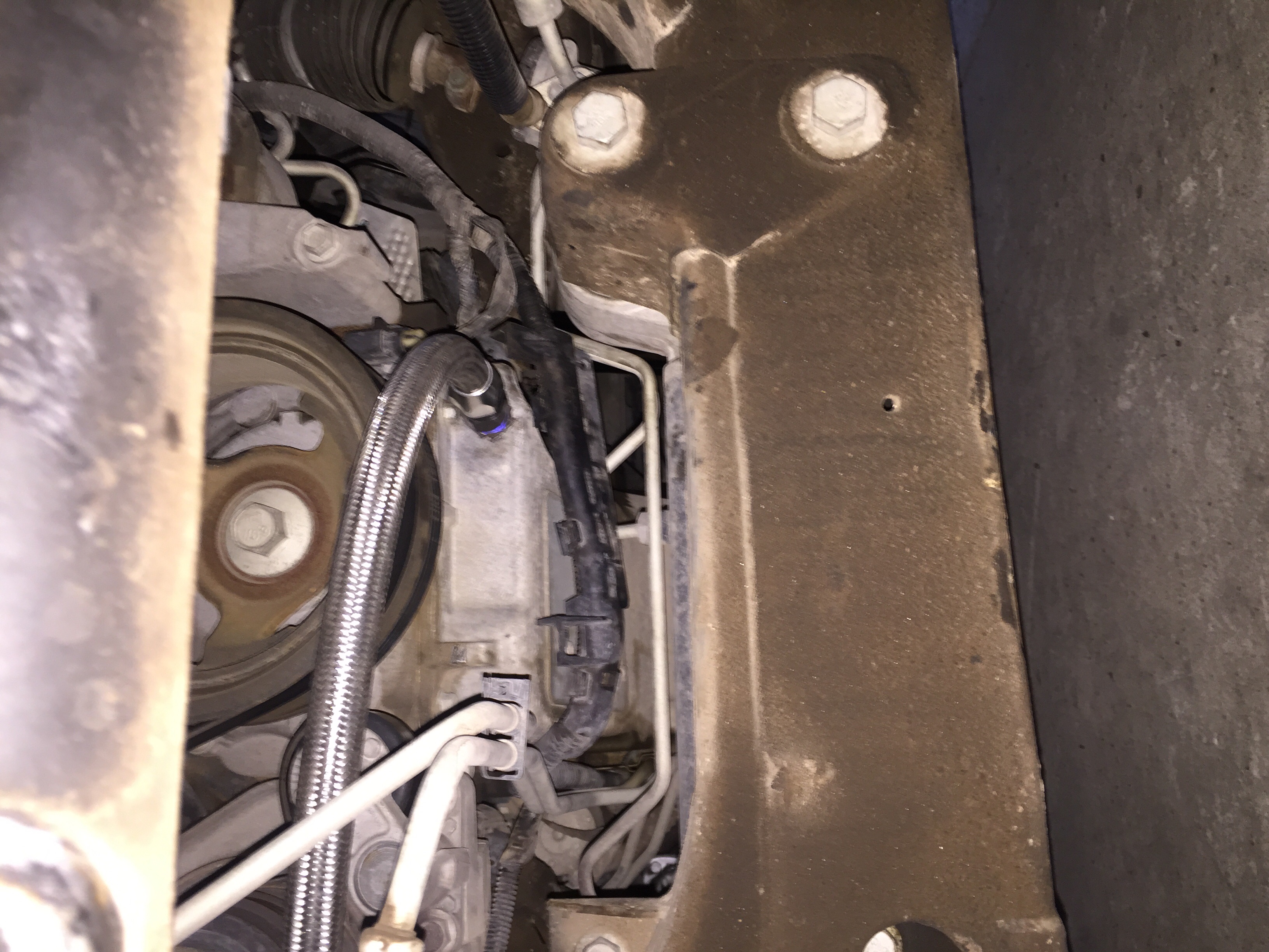

I think your problem is where u did ur drain ........ ur under the level unit which means that oil might be already on the line..... we recommend to do it where Jordan did his or on the side throu where the compressor is .....

usually we recommend to do it in front of the pan theres no oil there all ur going to do is return no will be there or look for the highest place on the oil pan ....... now if its still smoking ur turbo might be bad... I have had issues like that with brand new turbonetics

Here's a pic of mine
