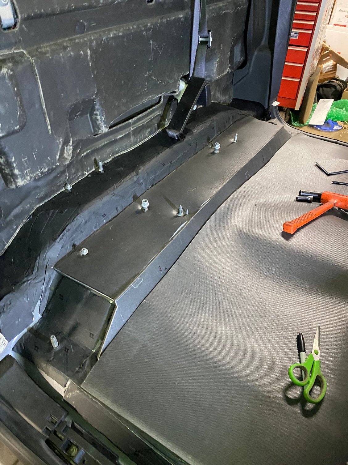

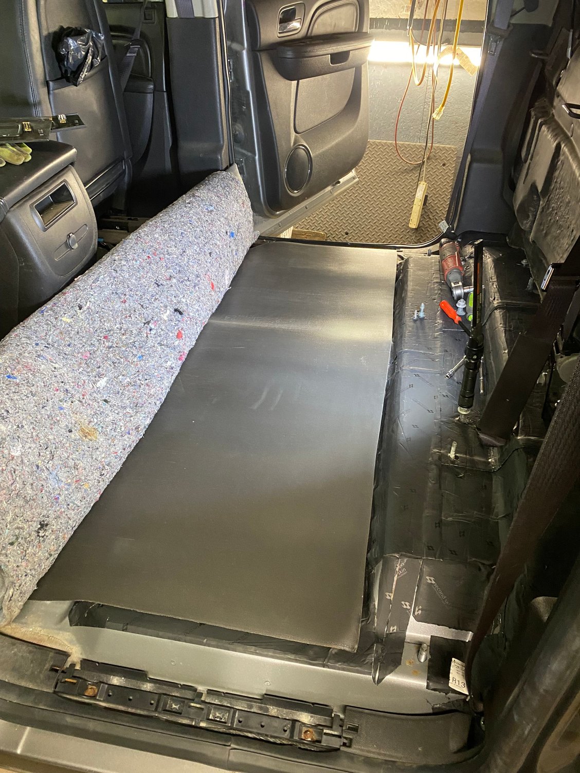

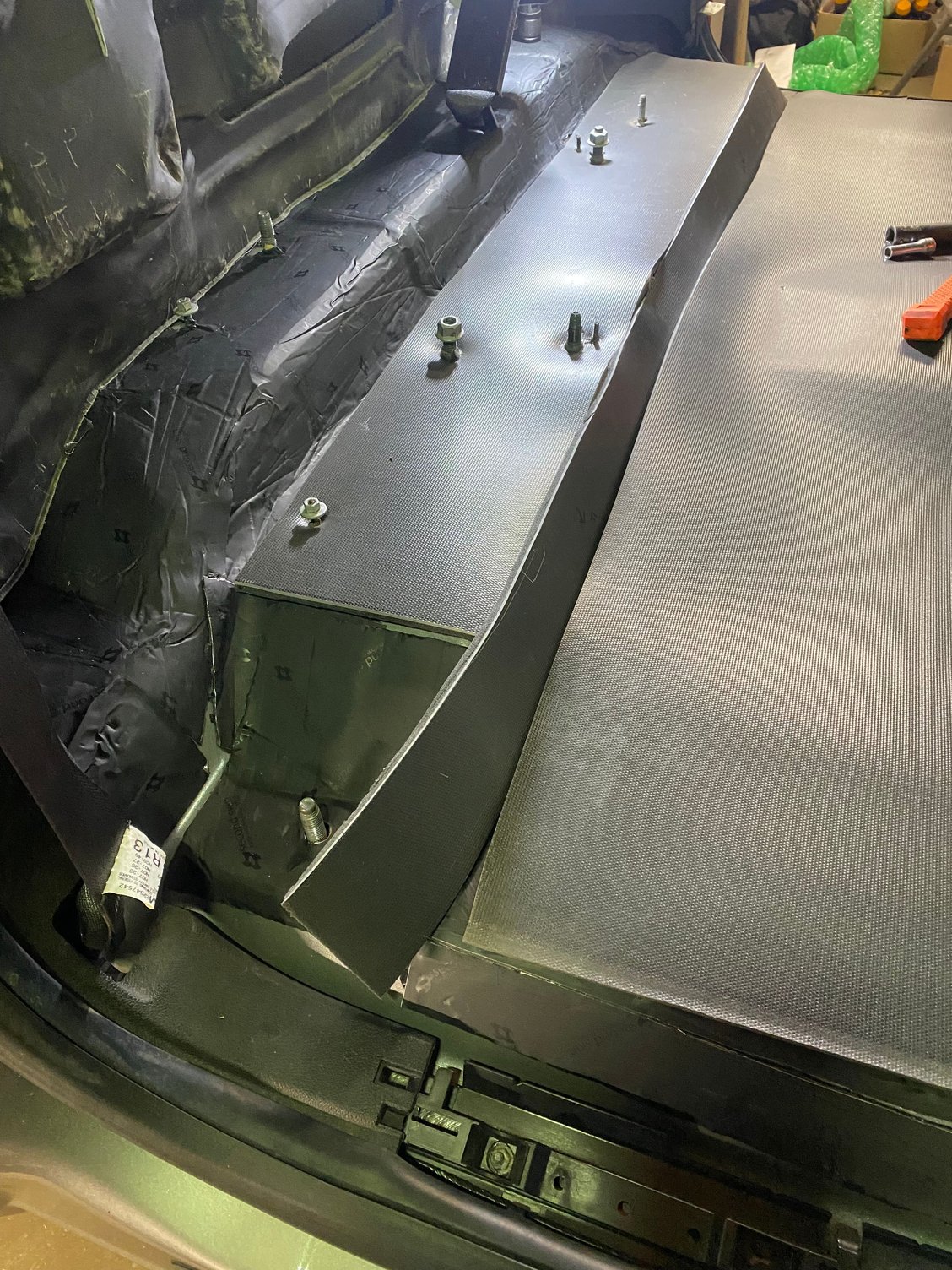

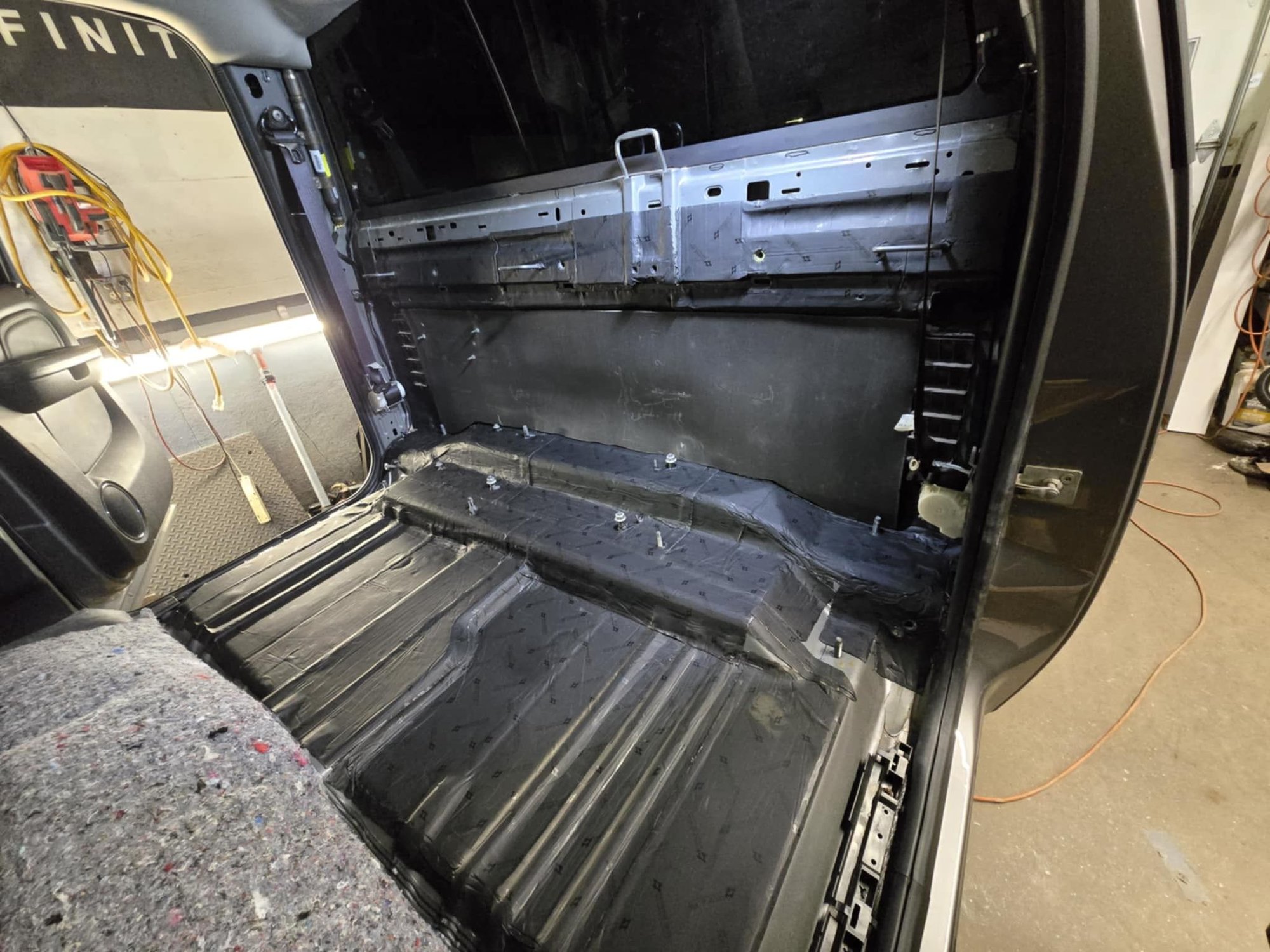

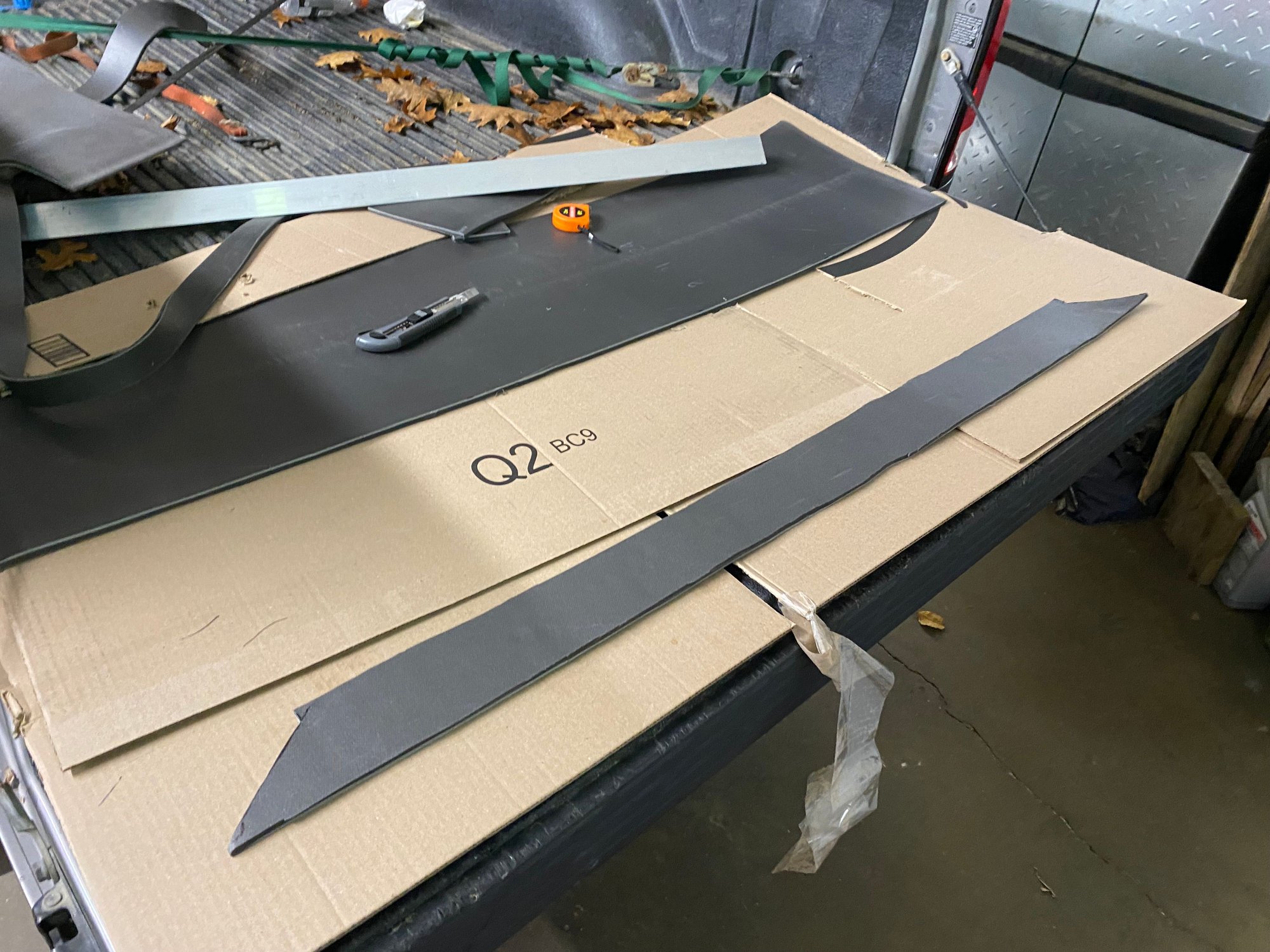

Finally got the truck back from the body shop after 6 weeks there. My god this is dragging on. On top of that I found out my tuner is away for a week now: Took the rear seats out to add sound deadener. A layer of Second Skin Damplifier Pro is done and next is a layer of Luxury Liner Pro. Also upgraded the belt tensioner and swapped the 2 90mm idlers for 100mm.

Finished up the rear interior sound deadening with Second Skin Luxury Liner Pro on top of the Damplifier Pro.
