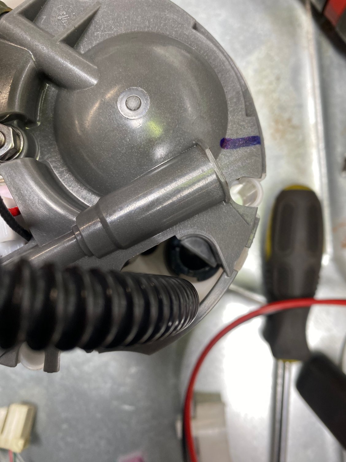

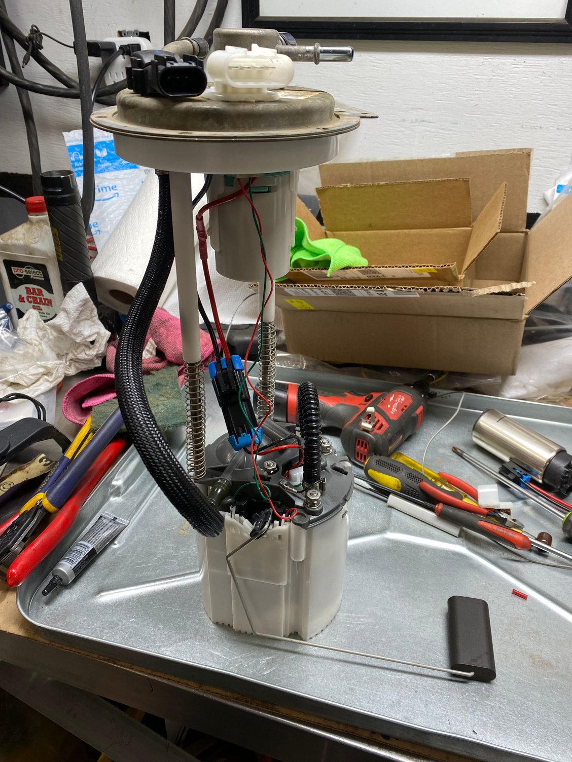

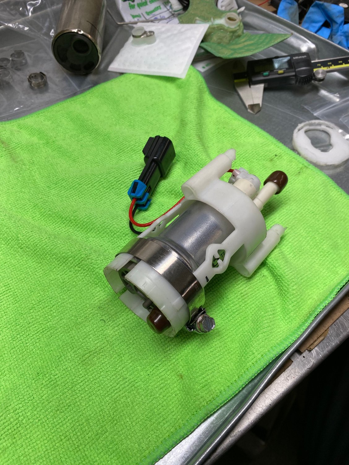

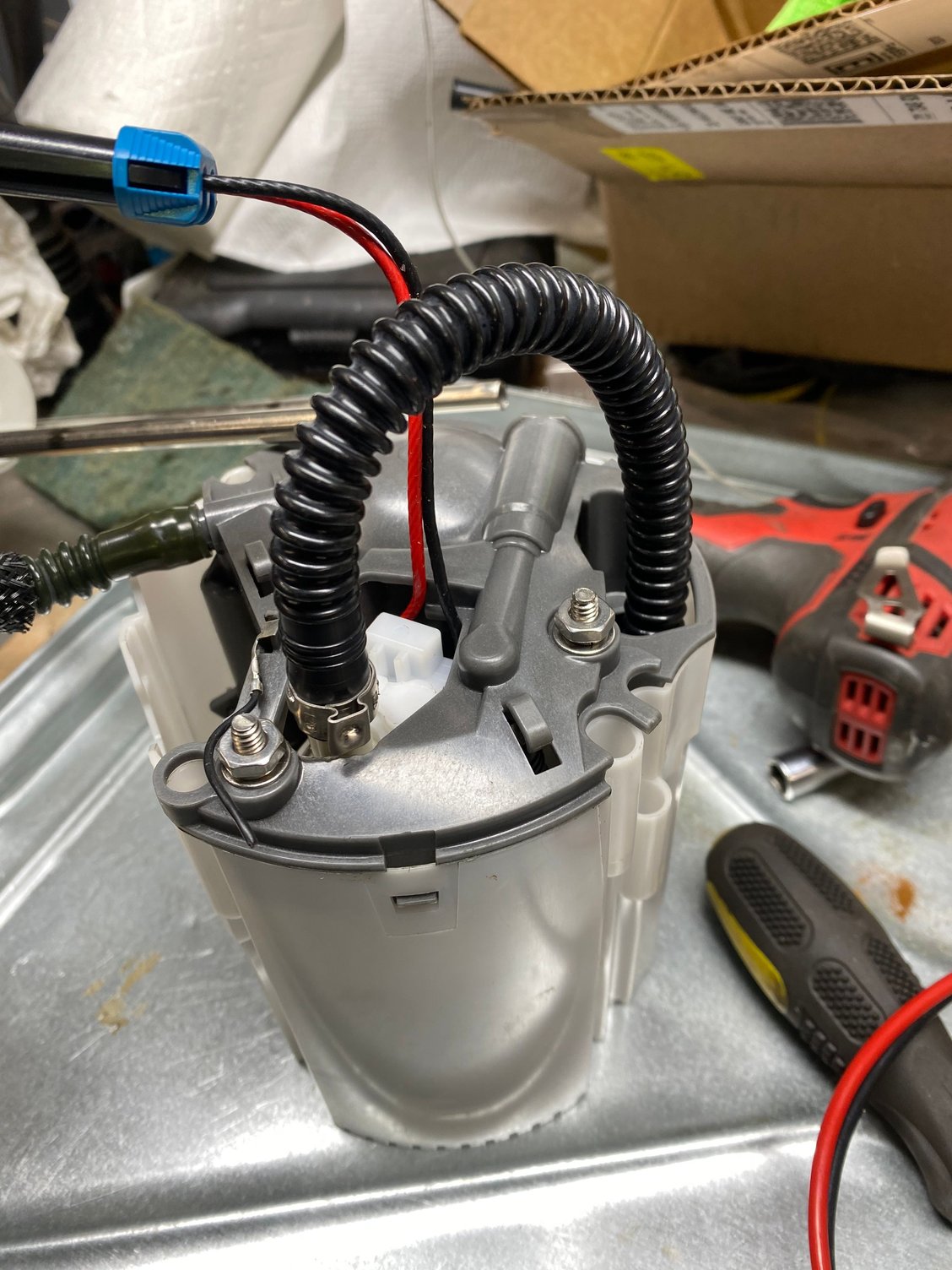

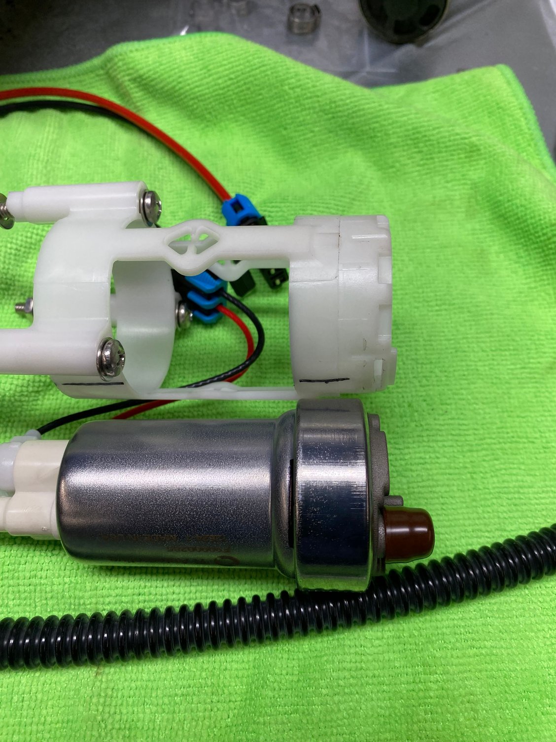

F90000285 pump aka 470 LPH
Cutting floor out of pump holder
Drilled the holder out of the dark gray post-pump filter/regulator housing with 5/16" drill bit. ( started with smaller bits and worked up to 5/16")
Cut the lower part of the holder to accommodate the larger diameter bell portion of the 285 pump.

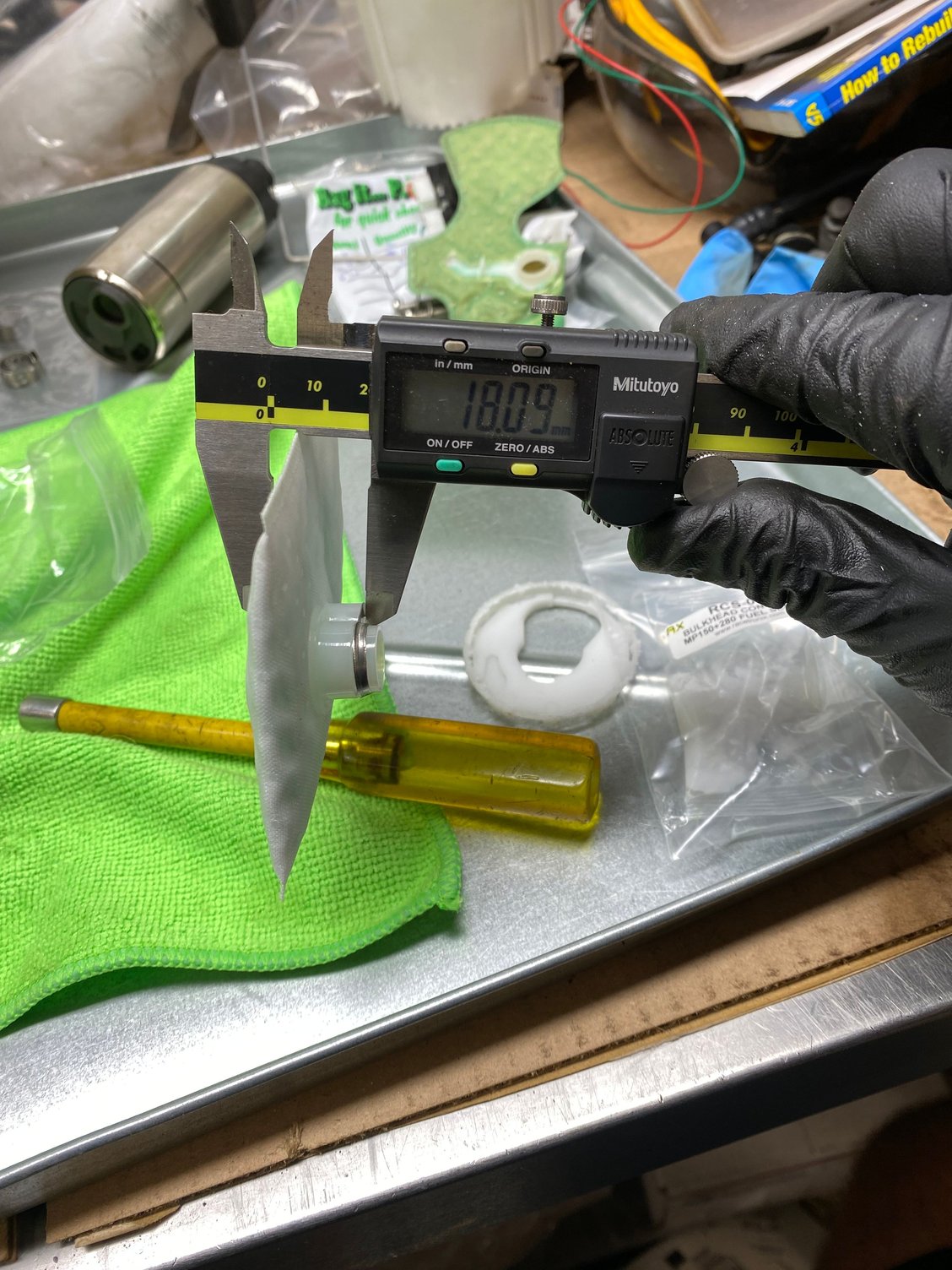

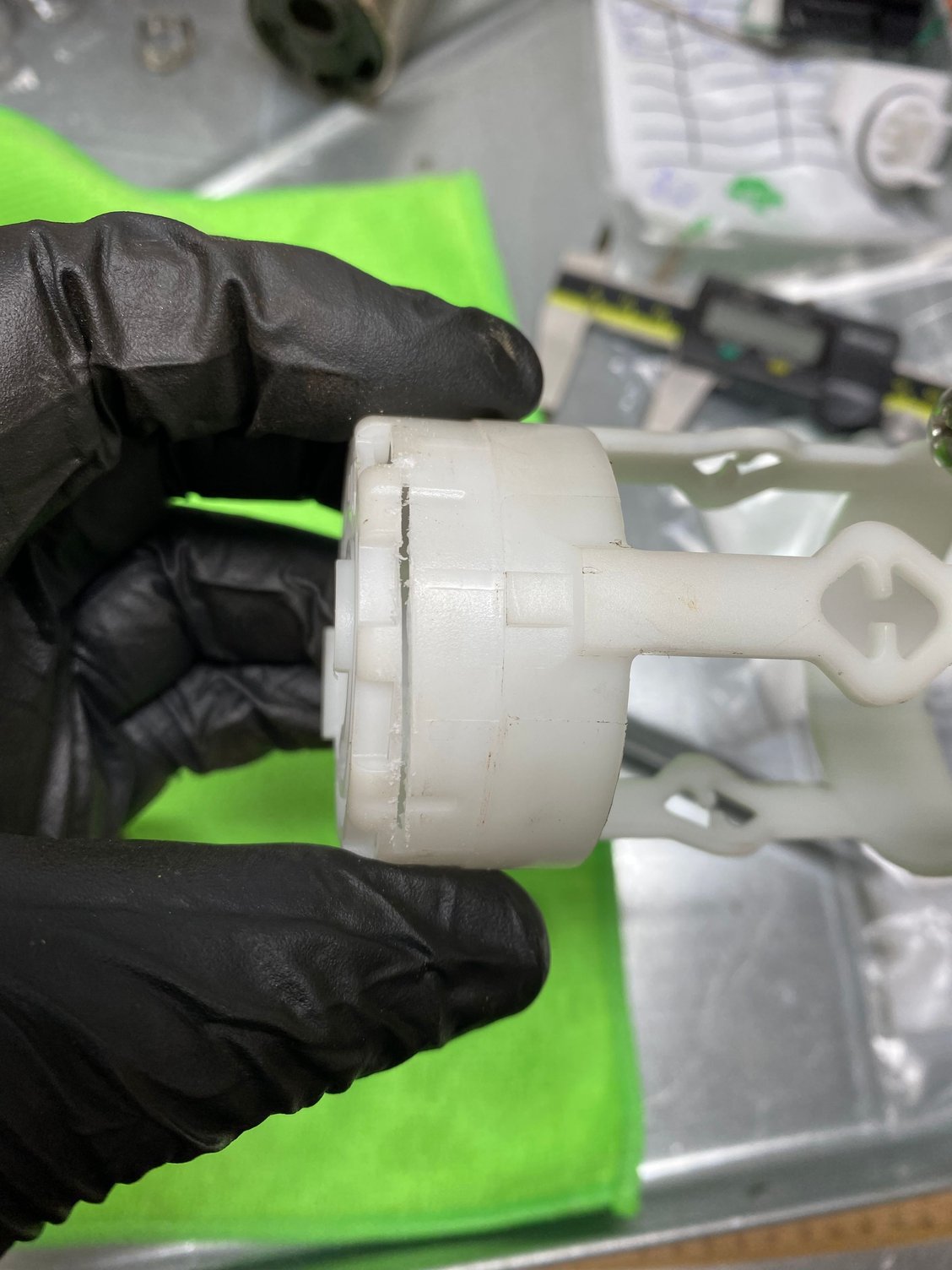

Measuring how far The inlet sock sits off the floor of the bucket
Measuring the new inlet sock from Racetronix to keep everything relevant
Old Sep 2, 2024 | 12:03 PM
  #45
infiniticrypto's Avatar
Joined: Jun 2024
Posts: 96
Old Sep 2, 2024 | 12:06 PM
  #46
Joined: Jun 2024
Posts: 96
Finished product. Will probably only be in the truck enough to get the truck down to the body shop to get some work done to the bottom of the fenders and the bottom of the bed and the rocker panels and then I'll sell it when I get the purpose built TI Automotive Module.

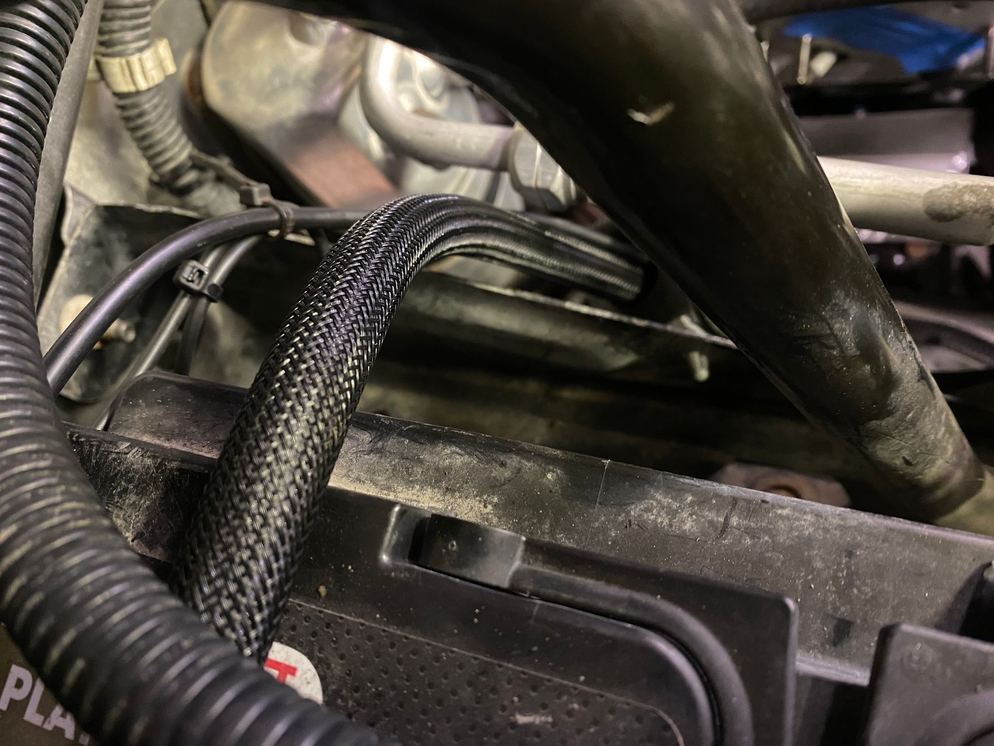

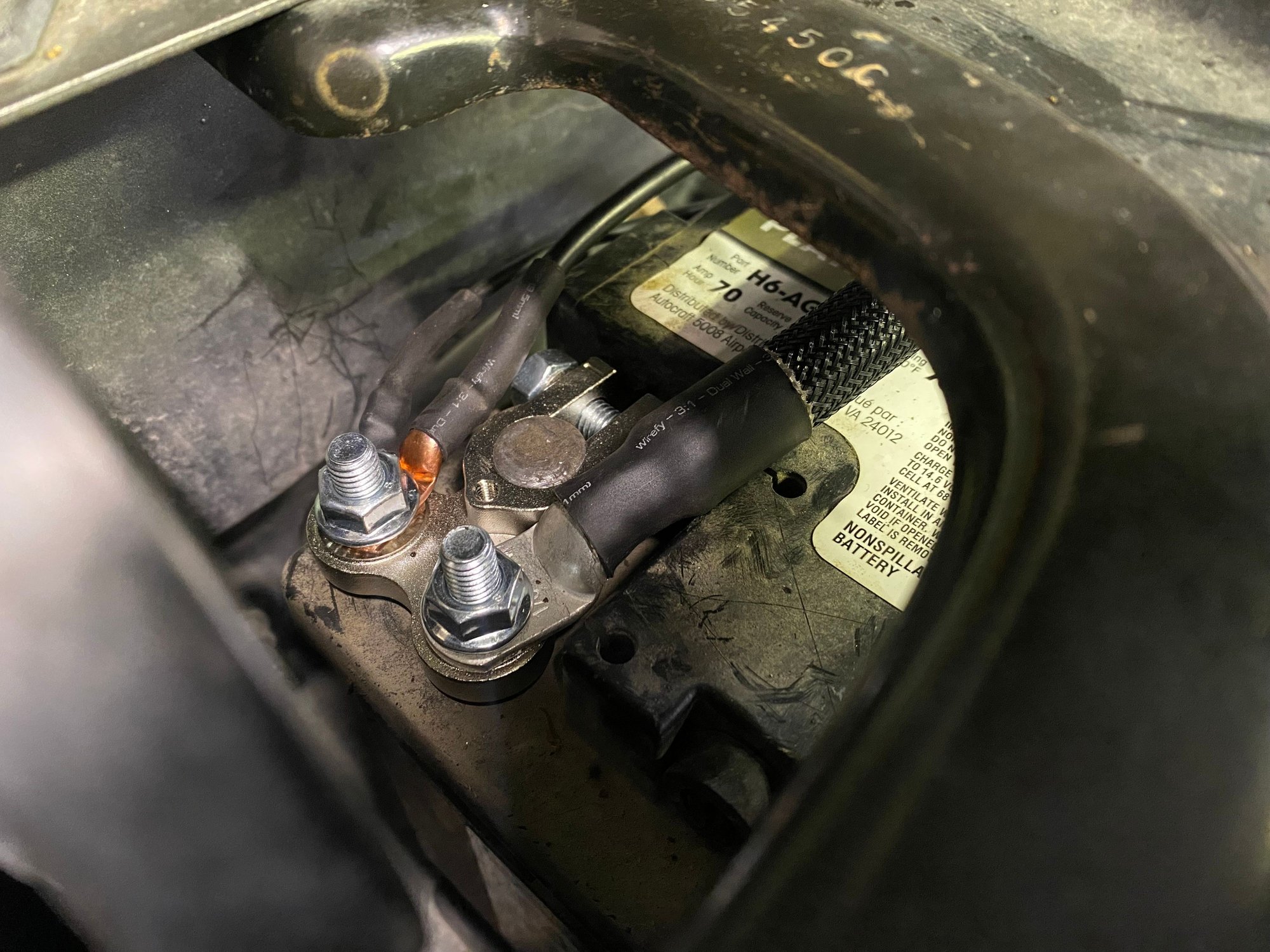

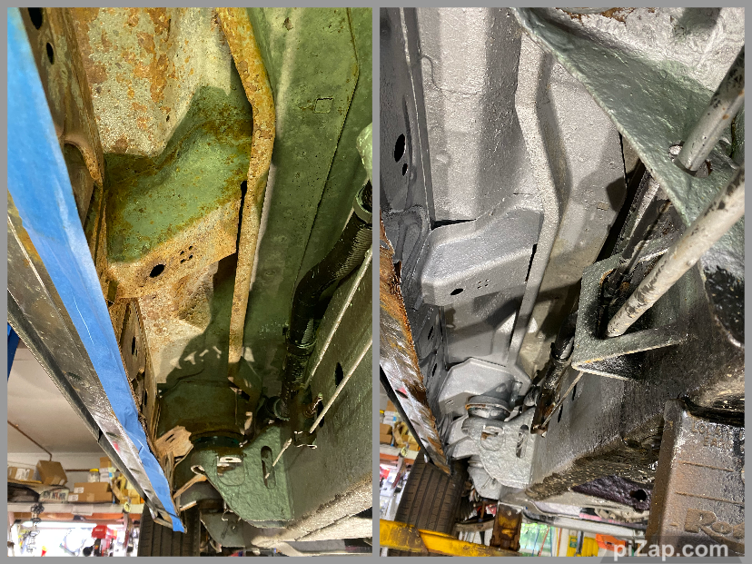

Factory battery ground cable
1/0 welding cable and 8 AWG, running through factory current sensor.

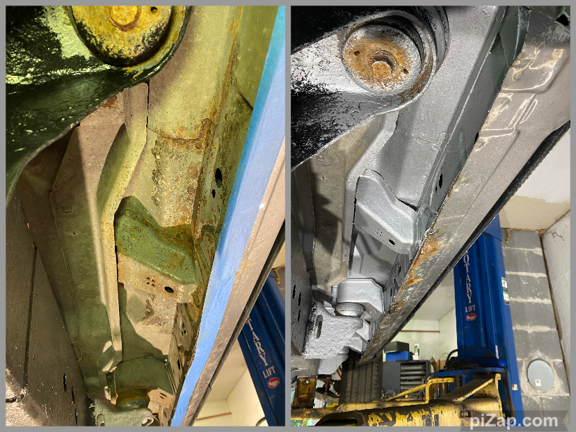

Cleaned up the floor (underside) outboard of the frame and also the inner rock panels. Coated with Eastwood Rust Encapsulator Platinum.

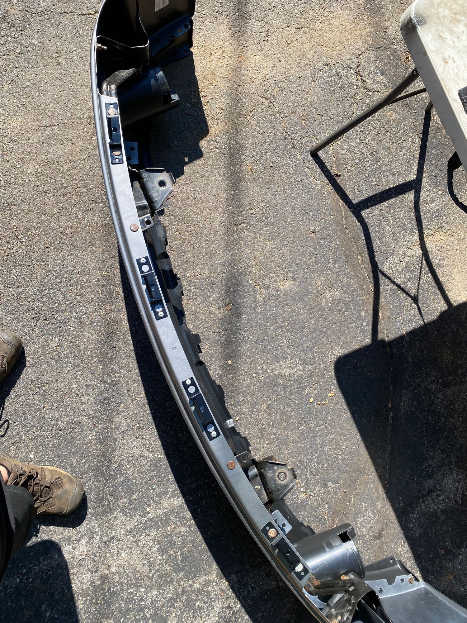

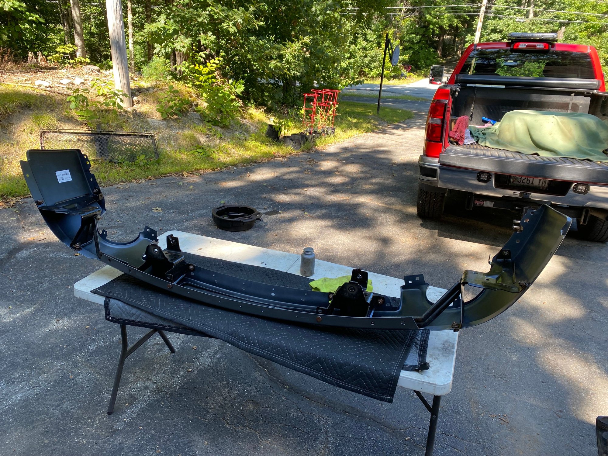

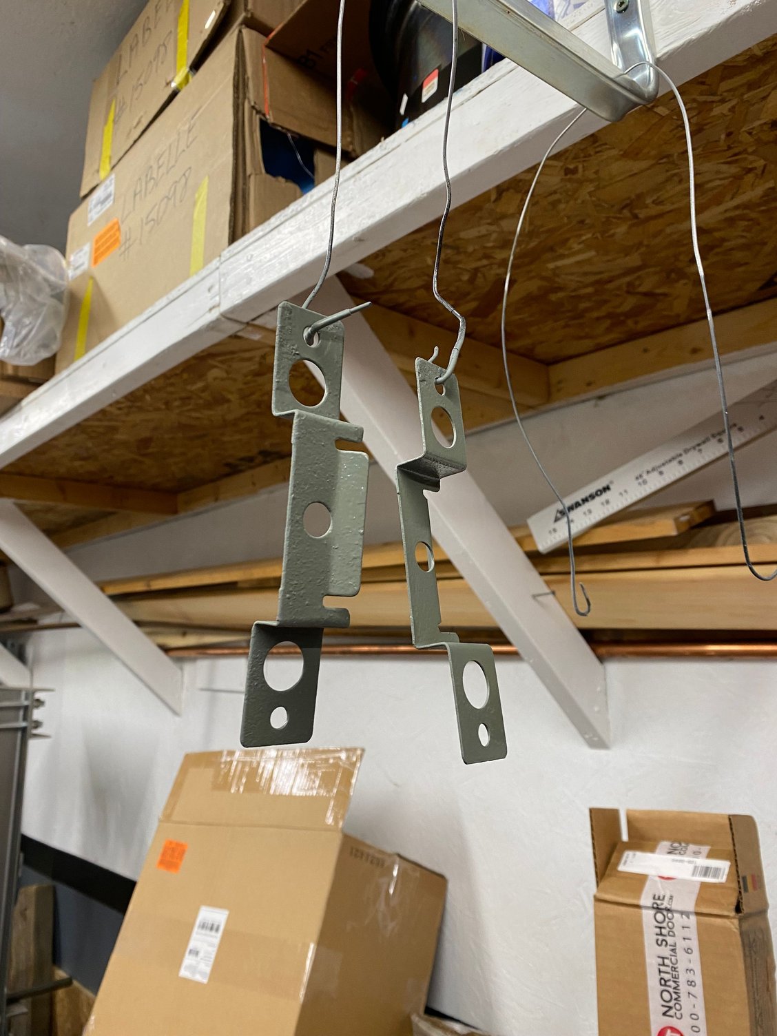

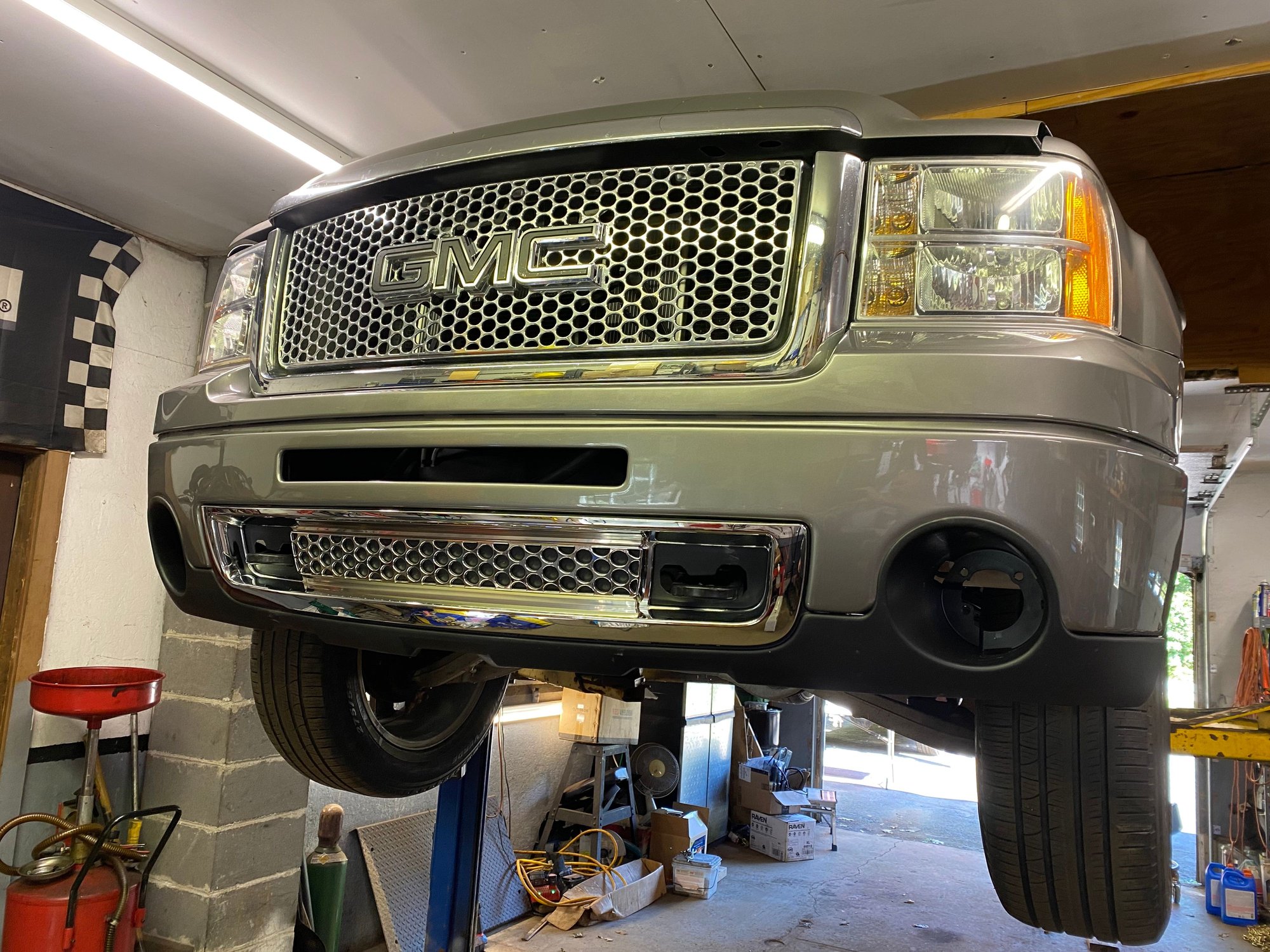

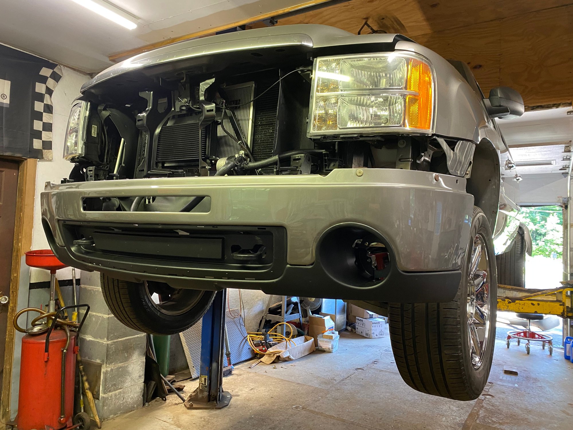

Front bumper back from paint.
Old bumper, time to swap all the innards. This thing must break down to like 60 pieces. Probably the most tedious work of the entire project. I'll need to clean up those rusty little brackets.

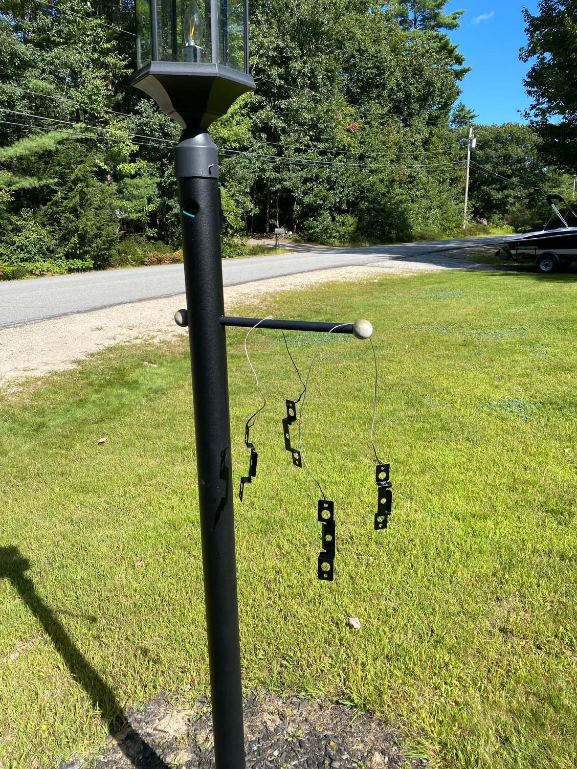

Primer after some bench grinder wire wheeling.
Using my wife's lamp post as a drying spot.

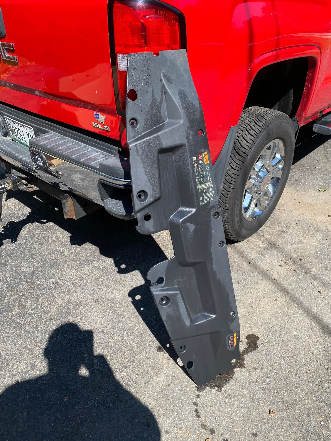

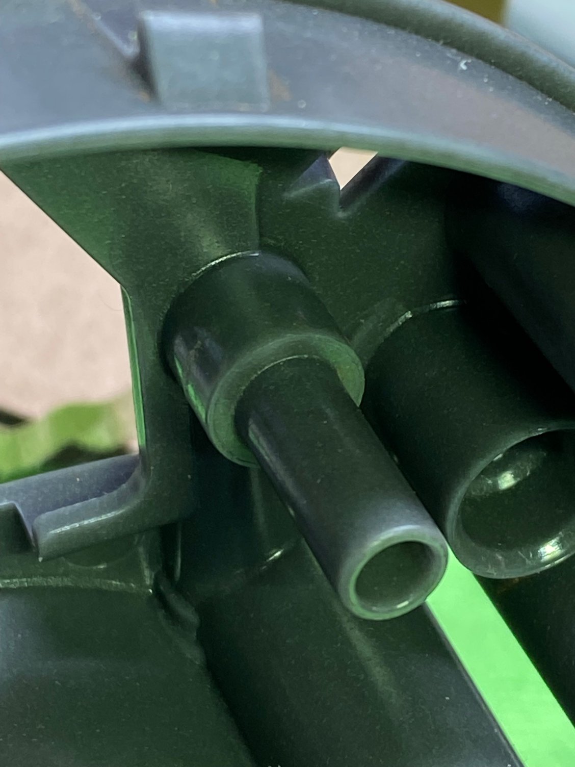

Lower air deflector extension.
Drilling to 6mm for plastic rivets to hold plate bracket.
Plate bracket riveted.
