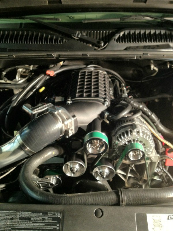

And here is the configuration, been running it 2yrs with no issues. Not many miles as its not my DD.

Showoff lol
