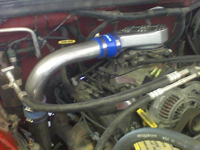

This is the mock up on my cuz truck. He wanted more power to pull 35" tires with 20" wheels. It's a t-60 turbo from a STS kit. The turbo flange pipe and wastgate is from the STS kit that was on my HD.

I was thinking a 5.9 cummins, not a 5.9 gasser:LOL:
Doesn't look too bad but I still do a double take when I see those remote mount turbo's, it just doesn't look natural to me.

Nice, what are you doing for fuel control? Do you have to do anything to the map sensor signal?

24# injectors and reflash by PPH. We're not lookin to get craze, so boost will be set at 5psi.
