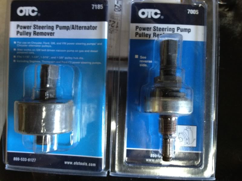

Just wrap the back side of the pump/pulley with wet wrags, you dont need much weld on it so its not going to see massive amounts of heat, dont overthink it, its pretty simple
You just need to fuse the pump shaft to the pulley, just so it wont spin off.
Heres the pulley installer / remover i bought from amazon for about 50 bux.They work great.
