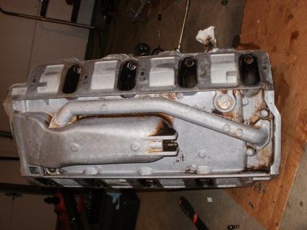

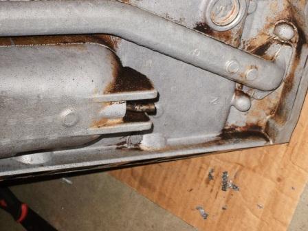

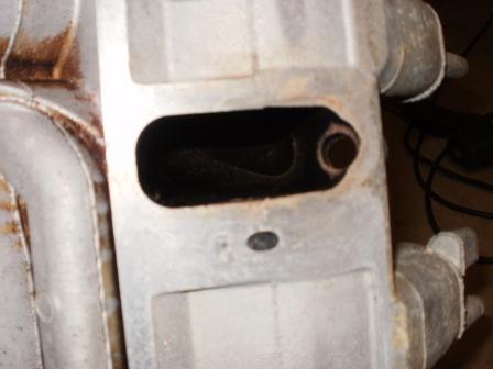

hey guys, i recently bought a 2006 sierra with the 8.1L.
I currently have the intake manifold off and sitting in my garage. I will post pics when i can.
Before reinstalling I'm wondering whether i should plug the pcv tube in the intake and run a traditional external pcv setup ? looking inside the intake it's all brown/black with oil varnish. I was getting P0101 MAF out of range on my first drive home from the dealer, among other problems. I just don't know how reliable this internal pcv system is because you can't see it.
