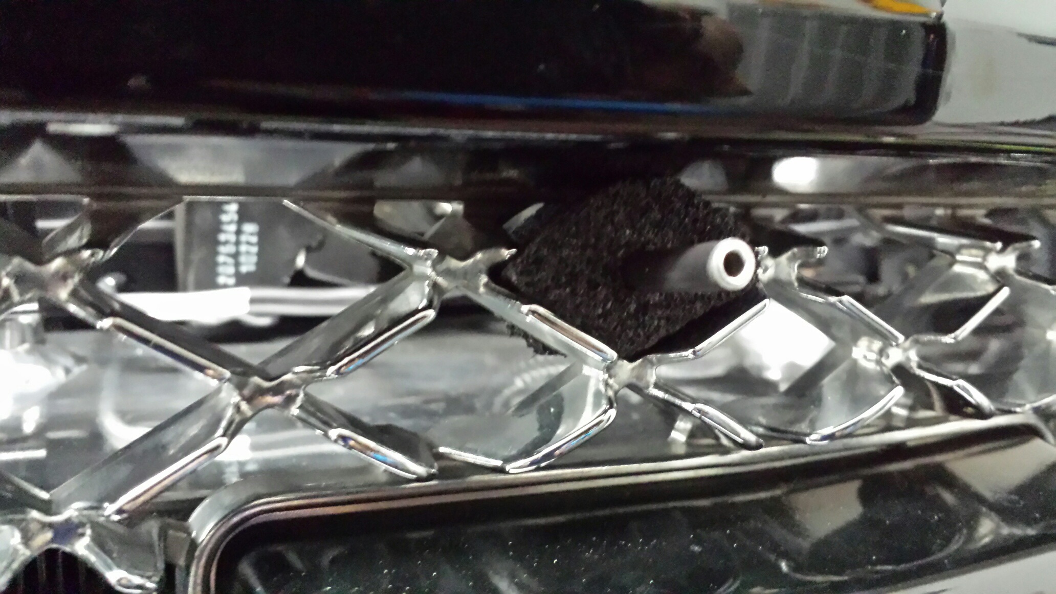

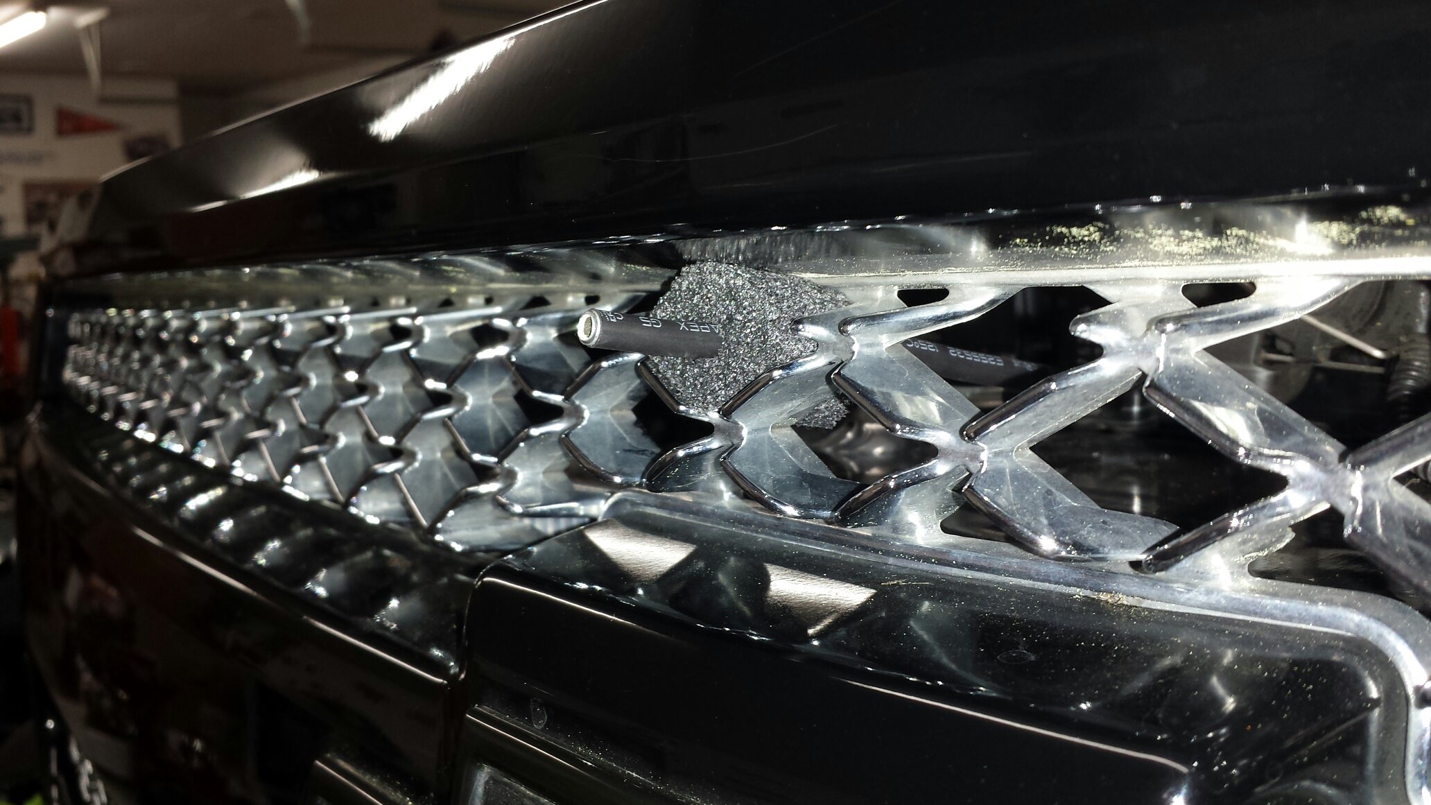

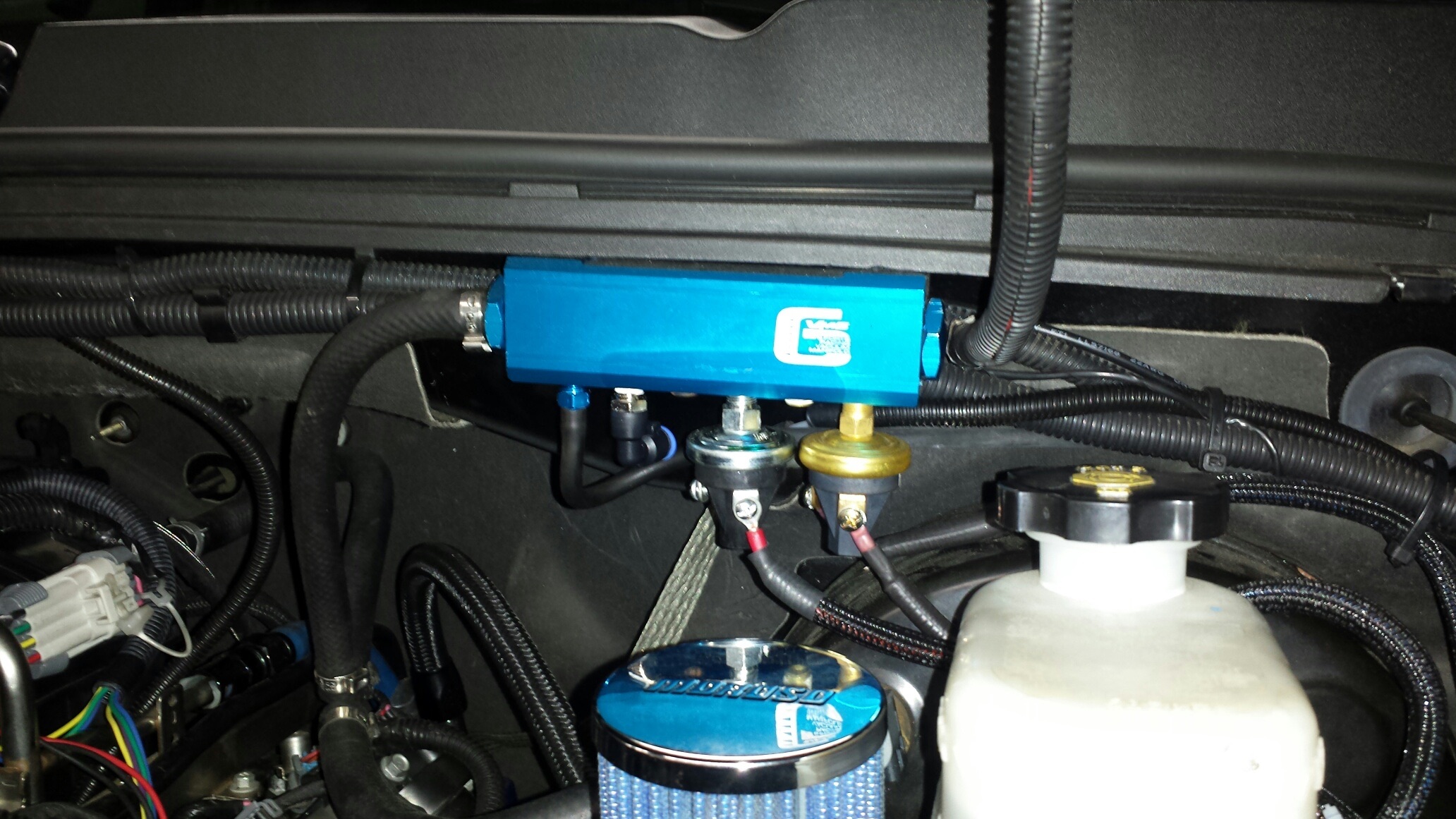

6.2 turbo build-image.jpg this is the hobbie switch that I will set to turn the nitrous off after I get full set boost.

Originally Posted by Byrdman11
Attachment 73809 this is the hobbie switch that I will set to turn the nitrous off after I get full set boost.
Mark make sure Hobbs are controlling relays not solenoids directly.
Why 2 Hobbs?
Old May 1, 2015 | 06:19 AM
  #878
Byrdman11's Avatar
Joined: Mar 2012
Posts: 1,791
From: Macon Ga
Solenoids are wired to relay. Hobbie are a switch to turn off relay when the throttle switch is close and flowing power to the hobbie and then to the relay. The other hobbie is there for the second fuel pump.
