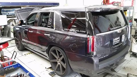

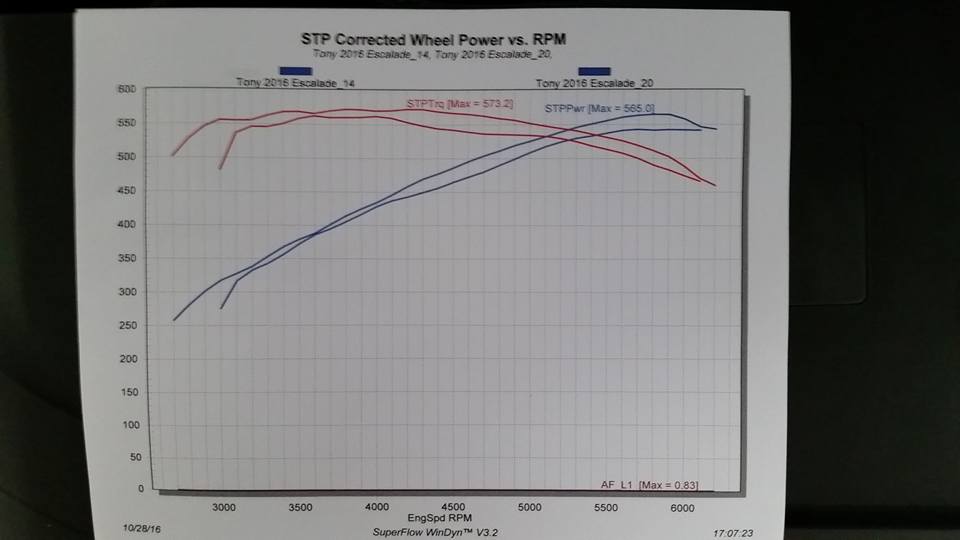

WELLLLLLLL my Whipple 2.9 Escalade making more power Very happy with numbers. 7.5 psi/91 pump gas/ARH Headers/3.5 MagnaFlow cat back/z06 fuel pump/fuel line mod and @gptuning tune. 565/573. Old run was 543/566 with 6.5 psi. What peak numbers don't show is mid to top end 20 to 30 rwhp/rwtq increase. We let off the run early that's the dip at end.
Alky kit coming so Goal is 600/600 at wheels at 7.5 psi with no internal mods....on 26s lol
I'm almost done with this project and its been fun.

Good numbers and good looking graph. Did you install the blower just to make up for the weight of those wheels?

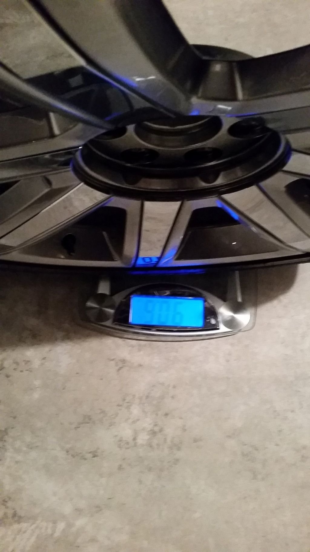

The 26 with tires weigh less then the 22s with tires. 285 45 22 is way heavier then a 295 30 26 also
stock 90.6
new ones 88.6

It's not just static weight that's important, it's the moment of inertia, which is obviously harder to measure. Great results though!
