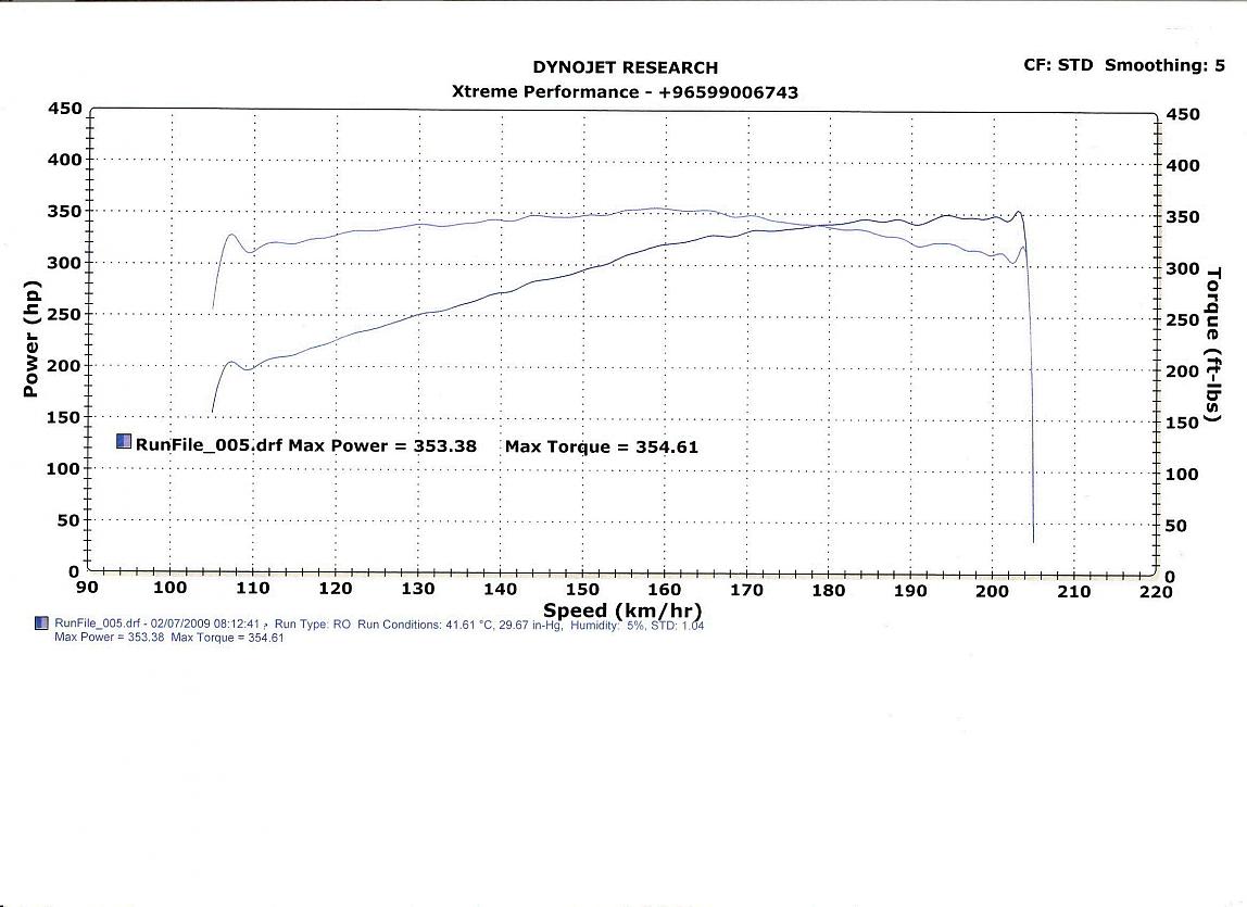

what is size you recommand for 9 psi now i have 4 inchs , i,m getting 5-6 psi shall i go for 3.4"

http://www.youtube.com/watch?v=FonavOWrG3c
http://www.youtube.com/watch?v=wyonz...eature=related
http://www.youtube.com/watch?v=gb-ja...eature=related
here is the run and the sheet

You should get Long tube headers with a y-pipe. It will make a huge difference. I think that HP is about right with the mods you have. What size injectors do you have?
