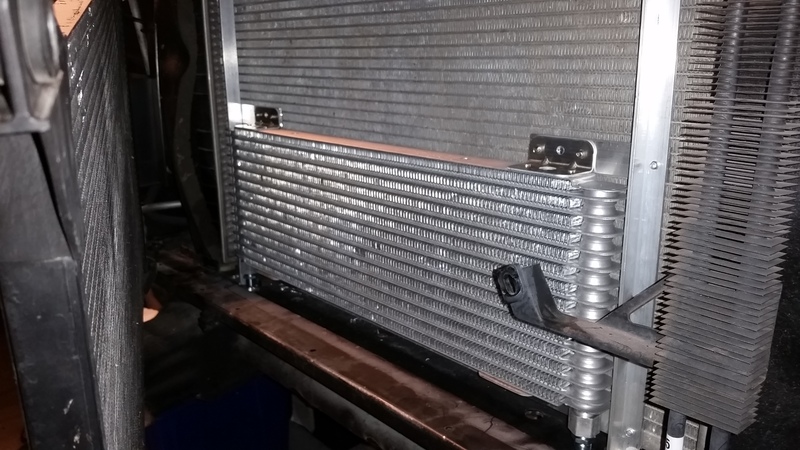

From: Lockport, NY
Size:  180.4 KB it'll fit in front of radiator, behind ac condenser.
Old Feb 18, 2017 | 05:36 PM
MikeGyver's Avatar
Joined: Jun 2005
Posts: 4,518
Likes: 244
From: Suburban Chicago
Much better than in front of IC
Old Feb 18, 2017 | 06:56 PM
TrickTurbo's Avatar
Truck Sponsor
Joined: Sep 2006
Posts: 4,466
Likes: 62
From: Wichita Falls Tx.
It's fine in front of the intercooler.
Old Feb 18, 2017 | 07:13 PM
LPCWS6's Avatar
Joined: Aug 2003
Posts: 424
From: Phoenix, AZ
here is mine anyways
