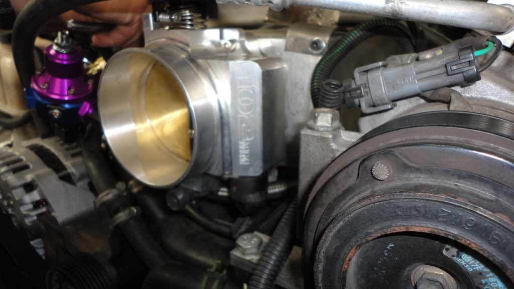

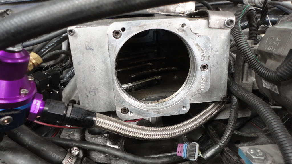

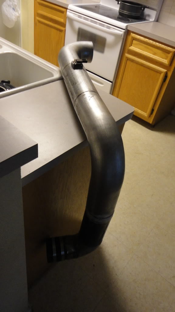

they do make 102mm TB's i bought a 30 dollar maf adpater off of ebay and welded it to the 4 inch intake pipe. I am SD anyhow but we use it for measuring airflow
