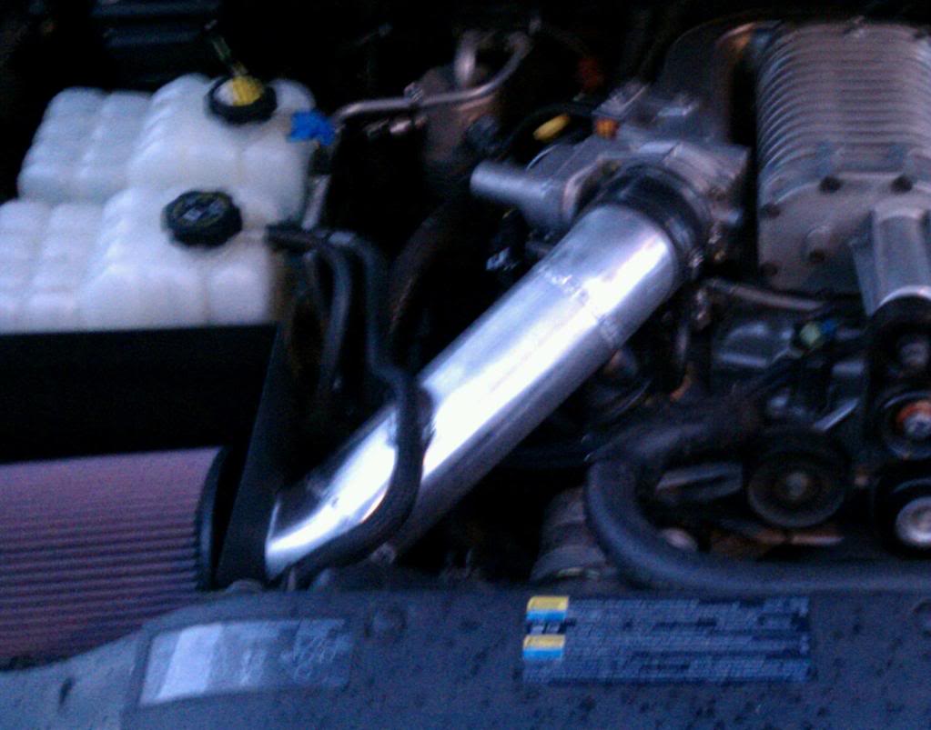

The 90mm blade is an ID of the flange dont forget. The outside is a great match for a 4" silicone coupler. I just made mine out of 4" aluminum tubing and an elbow. Plus you are getting close to maxing out the MAF.
