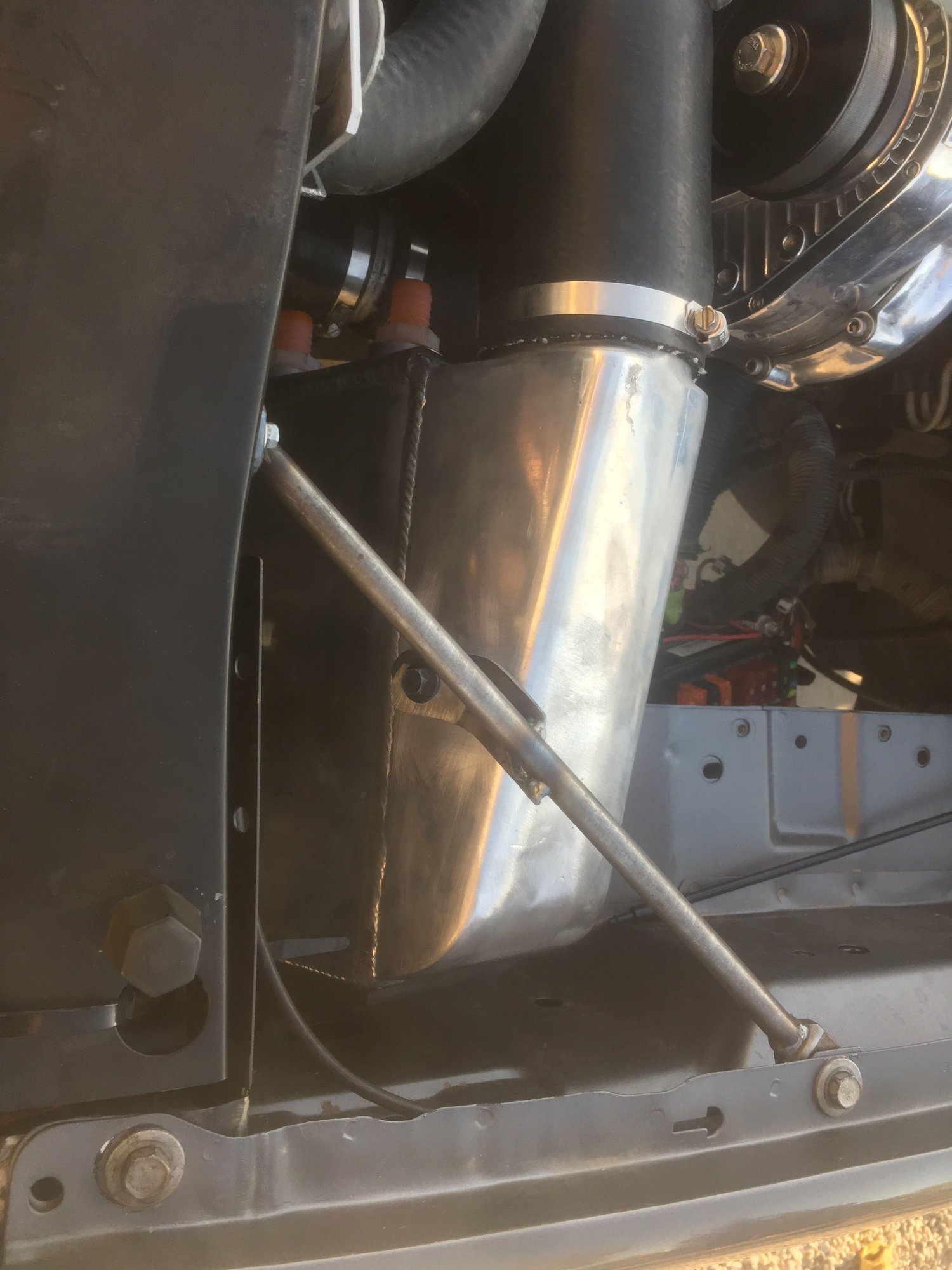

Where do you have the W/A IC mounted?
Im looking at their larger IC and wondering where i can mount it on my 2500HD

I'll see if I can find some pics, I relocated the ECU and battery, and the IC is behind the driver front headlight where the battery lived
I also removed my washer fluid at the same time because the reservoir was broken. I haven't added that back in yet
