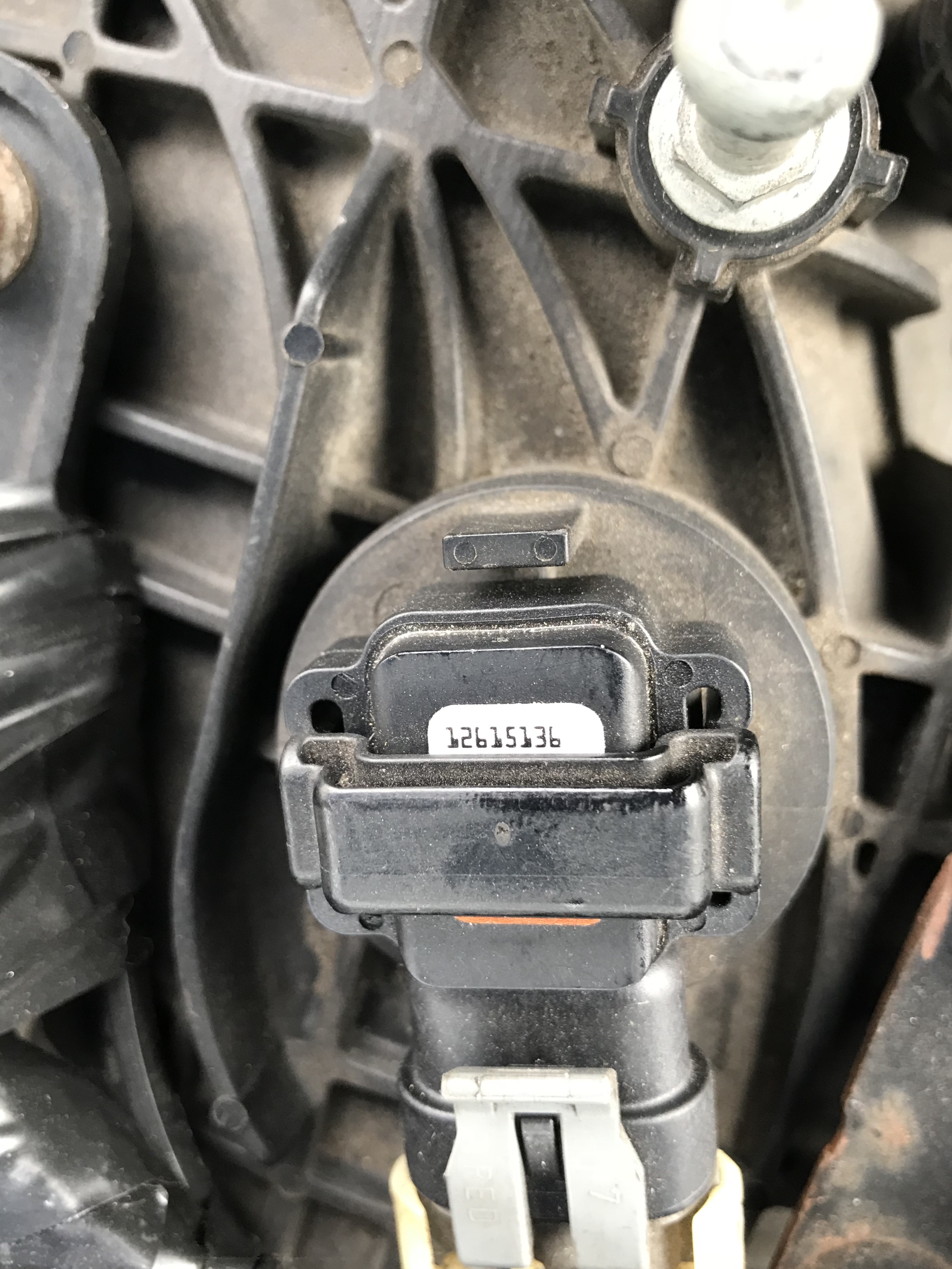

Cobalt 2 bar MAP, I used that on my 02 running SD
Attached Thumbnails 3 bar or 2 bar senosor on needed?-7683021a-8fc0-4392-978f-fa18adc10183.jpeg

Part# 12615136 GM 2 bar
