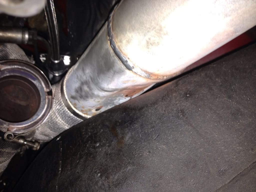

The closer you are to the manifold and high EGT, you can get away on the smaller stuff. Further you go back and it cools off the big stuff helps.
Mine is actually closer to 2.5-.2.75 because at the time Kyles jig was off and my downpipe mounted to close to the frame. It's self clearance to this point now.
