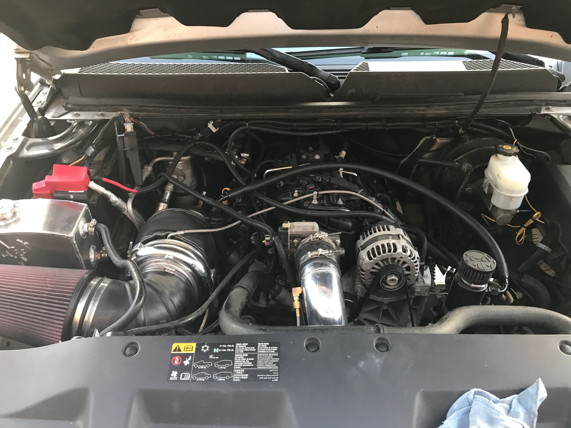

Hit the turbo and charge pipe with a little polish tonight.
