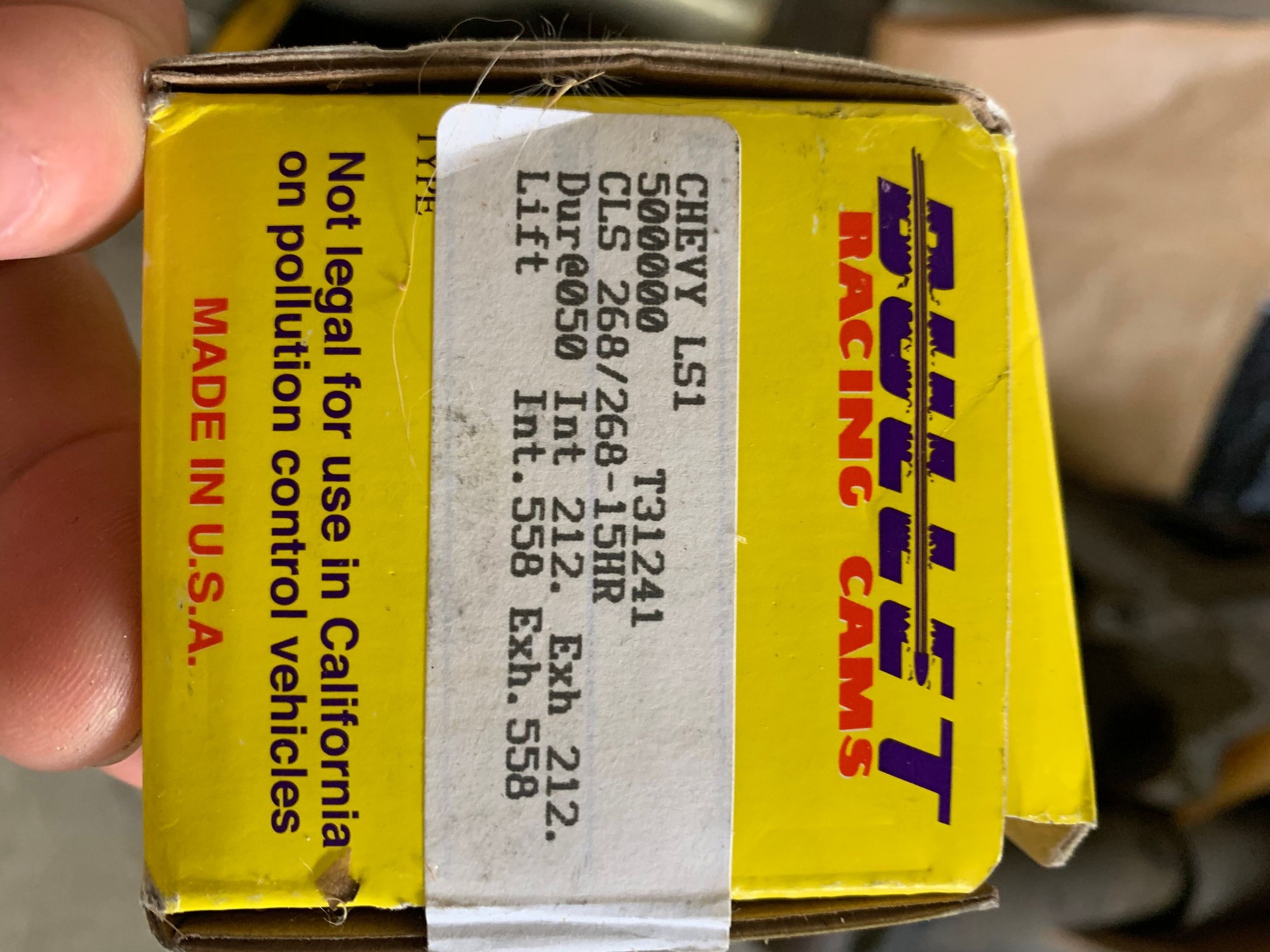

If you're running an LMG, that engine came with DOD and VVT. It sounds like your mechanic installed a cam ground on a non-VVT core. The LMG/L99/L94 engines park the cam 8.5 cam degrees advanced. You said your cam is ground with +4 degrees of advance. I'm not 100% sure, but your cam could be advanced as much as 12.5 degrees and I believe this would cause major issues syncing with the PCM and loss of power. It's the equivalent of 1.5 cam sprocket teeth (360 / 44 teeth = 8.18 degrees each tooth). I don't think installing an LS3 fixed cam sprocket would work either if they have the indexing hole in the same location. Post a pic of your cam card.

thats correct on the cam. It didnt get ground with a vvt core like I thought originally. However, the truck isles and drives normally and I also had the cam installed prior to the turbo so I think if it was more than a tooth advanced it wouldn’t run very well, right?
Here’s the cam card. It is a 115+4

Maybe I misunderstood. That box shows "LS1", is this a single bolt cam? I'll assume that it is and Bullet refers to all generations as "LS1" similar to Comp. If you're three-bolt, the cam is not the problem and disregard the following.
If your cam is non-VVT and installed in a VVT system with the phaser or an LS3 sprocket, that's probably the issue. I believe your cam is advanced 12.5 cam degrees. The cam you're using has fairly low duration and lift along with an LSA that would probably allow PTV clearance. A cam with that much advance would see high cylinder pressure up top and is probably why you were detonating. Idle smooth, take off like a rocket, and then fall on it's face. Seems like that's what you have. You said in an earlier post that the cam was degreed. Are you SURE that was done?
I also thought that was the problem. I did in fact have a vvt cam gear and non vvt cam because bullet screwed up. I had a single bolt non vvt cam gear installed and nothing changed. I’m thinking I have a degree issue. The guy likely installed it thinking it was a vvt cam, like I said it was. And since it wasn’t
a vvt cam. It’s likely over advanced. At this point, I’m going to swap injectors and have a btr stage 2 turbo cam put in there. Since the cam has to come
out anyway. I was looking through the dyno graphs of different cams and noticed l, even though this cam is over advanced, it still doesn’t make any more
power down low than the btr before 4500. Maybe a little more torque but that’s it.

If I'm right, and I do mean "if", it seems like a fairly simple fix. Just roll the cam back one tooth. I would still verify with a wheel, but I wouldn't swap the cam.
