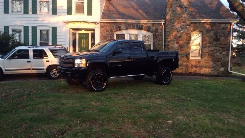

Hi I have a 2011 5.3 Silverado that is my daily driver. So far I have a magnuson 1900 supercharger tuned by black bear, pasesetter long tube header, off-road y pipe and a borla s-type exhaust. In the spring I plan on getting a smaller pulley 3.2" and new injectors probably 85lbs. Any other suggestions on mods my goal is mid 500's at the tires. I know I should do some head work and cam but I don't really know much about them. I also thought about watermeth to keep it cold. Thank you for your suggestions
