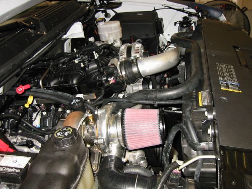

Just another update. Got the maf mounted in a location I was happy with and all we're waiting on is one silicon hose.
The heads and cam went in find after a little troubleshooting. This truck HAD the 4 clinder thing, displacement on demand.
Now it has a head and cam package with about 8psi.
I'll keep you updated on the HP output.

The NNBS guys are in for ALOT of fun... just can't believe the ease of charge pipe routing... fantastic job.

Allen is this going to be an issue with no heads and cam @ 10psi. WE should be finishing about the same time.
These 07 have a freaking huge amount of room in them.
Rick

Is yours going to be an issue, shouldn't be. As long as the a/f ratio stays rich under boost and the engine doesn't detonate, it'll be fine.
I'm curious how this smaller turbo is going to work out, it mght boost a little to easy, if so, we'll change the housing.
i'll keep you updated,
allen
