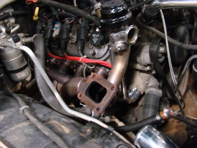

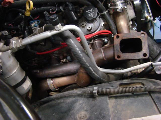

Do you have any pics of the spark plug access on the turbo side?

I posted this up to show some people how we did the plug wires, access to the plugs is not a problem
Its hard to see in these photos but its all I have hosted up right now:

Default spark plug wires
have heard not a good idea to tie spark plug wires together.have seen ls engines misfire with wire tied together. GM master mech said tying wires creates a negative field around wires.which caused the misfire.
Old Mar 6, 2014 | 07:29 PM
  #64
98tdi's Avatar
Joined: May 2012
Posts: 136
From: Shawnee, Kansas
Mine have been zip tied together for 15000 miles and no issues yet
Old Mar 7, 2014 | 09:08 AM
  #65
tim wellington's Avatar
Joined: Apr 2013
Posts: 551
From: eastern nc
Smile wires
like i said i heard that. example they are people running 12 + lbs of boost on stock engines with no problems and others stock engines have not made it pass 10lbs. and they do sell wire separators for a reason.and being a mechanic for over 25 years never seen a car from factory with wire tied together .which would be cheaper that putting wire separators on them .and for the record msd ignition does not recomend....
