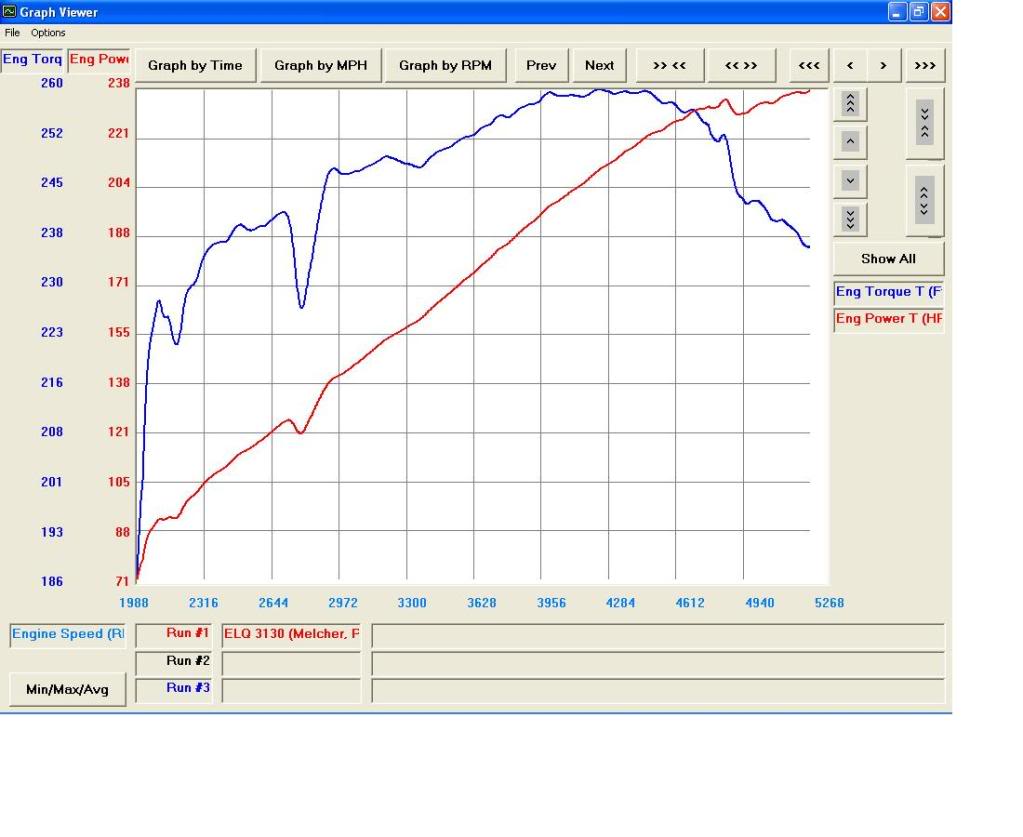

RESULTS: 243HP/262TQ
Video: http://www.youtube.com/user/rmelcher.../0/iw86tqYgB2M
To be honestly I was happy, looks to be a strong 4.8 and ready for the big stuff. We had trouble getting the wideband to stay in the tail, so no a/f feedback. Also, the Diablo was to aggressive on the long load pulls of a mustang dyno and the truck was pulling timing on the 93 tune, best number were on the stock tune.
Also worth noting, in 3rd gear with the stock tune, the stock MPH limiter cut us short on the dyno at 5200RPMS, but the HP line looked like it might of had a couple more in it but TQ was dropping fast. This wasnt the best HP/TQ dyno graph, but it was the only one he e-mailed me. Also got the driveshaft rebalanced and upgraded greaseable u-joints. Found out my slip yoke is shot, ordered new yoke and seal.
Graph: Name:  StockDyno.jpg

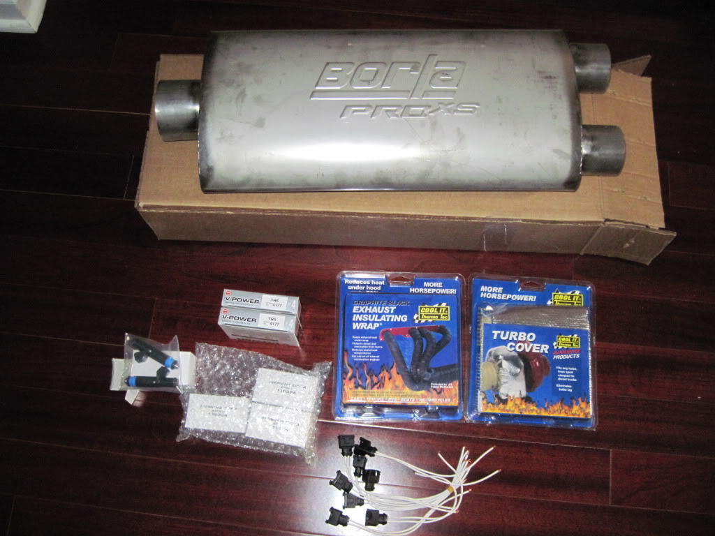

New stuff in:
8X 80lb Injectors
Turbo heat wrap
50 foot, 2inch black exhaust heat wrap
Tr6's

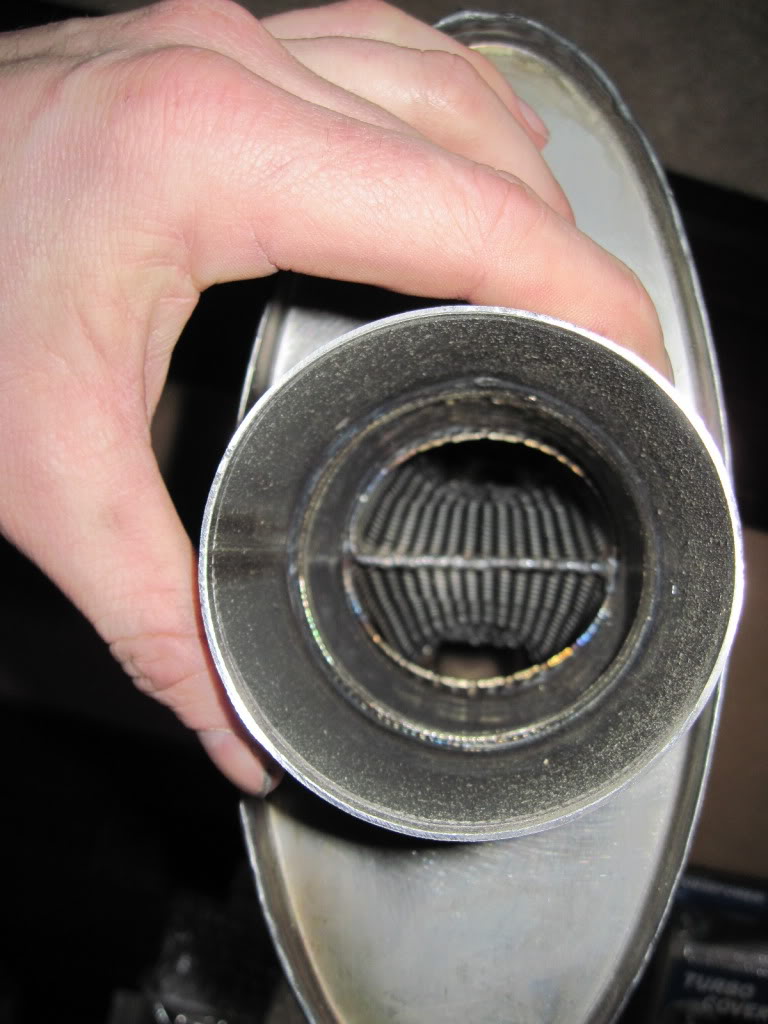

Borla Pro XS muffler. 3inch in, dual 2.5 outs
3inch electric cutout (not pictured)

Wow thats a strong stock engine!
Will be following your build as im doing the same soon.
Your gonna have a truck that runs as good as it looks!
Old Feb 19, 2010 | 08:49 PM
outlawz2004's Avatar
iTrader: (18)
Joined: Sep 2007
Posts: 2,633
Nice, made more tq than I thought it would.
