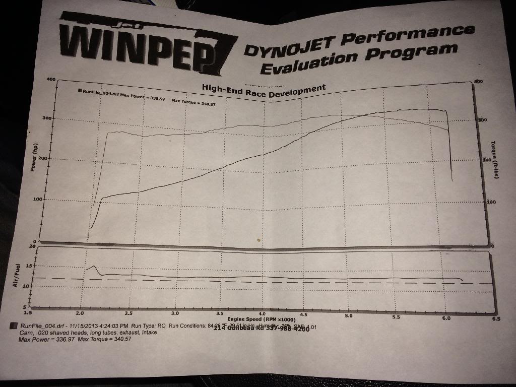

08 ecsb 5.3, tsp 224r 114 lsa, stock 243 heads milled .020, volant intake, LPP's long tubes, stock tranny with vette servo, stock 20's and 275/55 tires, High-end racing tune in Laffyette, 338 rwhp and 340 rwtq
I have my circle d 3000 stall waiting to be put in

Nice numbers! Do you have a picture of the graph, it would be nice to see the torque curve.

Thanks, i dnt have one on my phone, and idk how to put a pic on here from my phone, i can send it to someone if they dnt mind puttin a pic of it on this post
