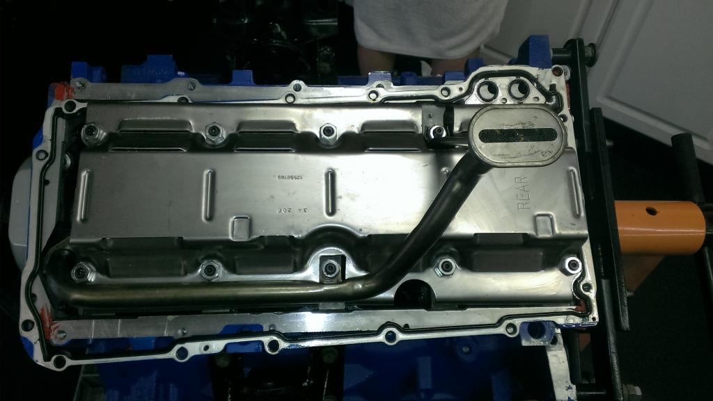

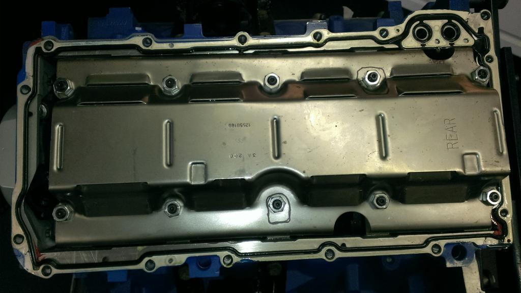

Bought an LS2 tray and made necessary spacing and cuts.

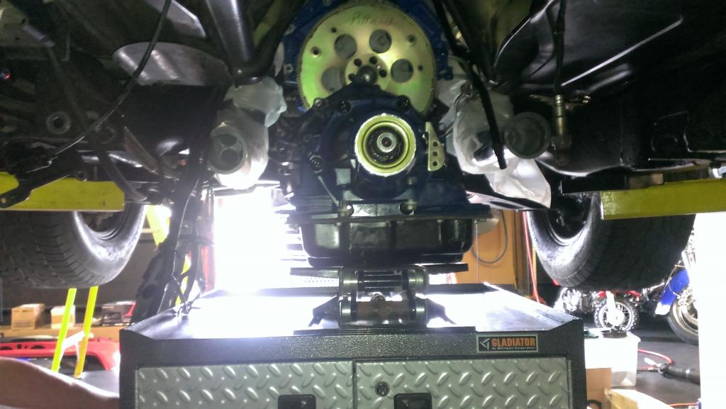

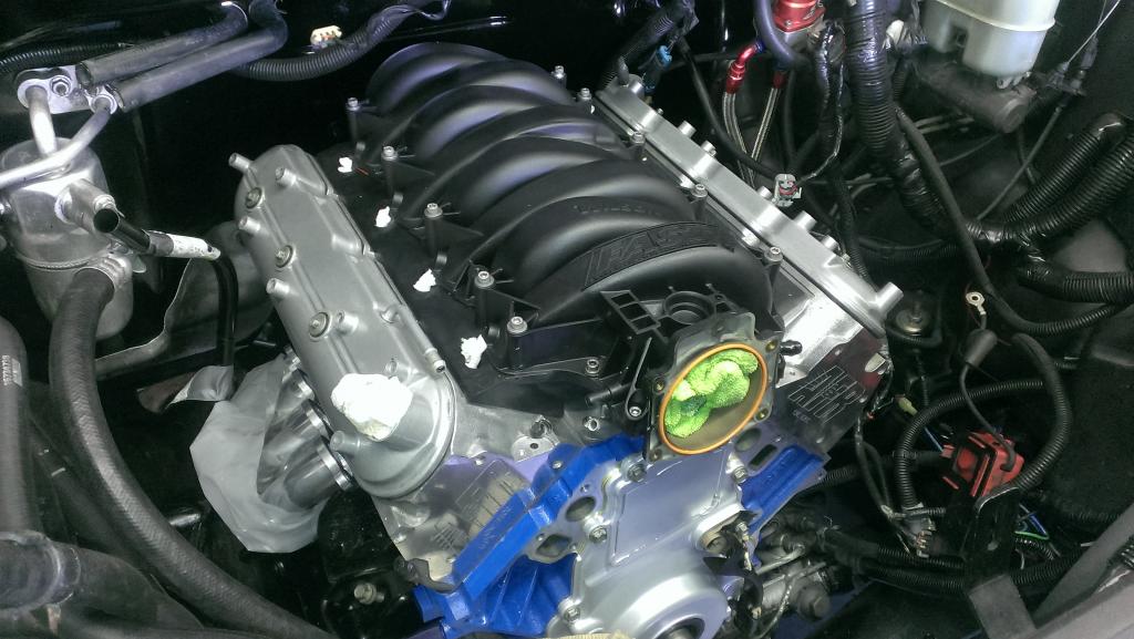

Got her dropped in last night. Hope to get tranny in today

Thx, slow going with just a few hours on the weekend. Got the tranny in and the front accessories bolted.
