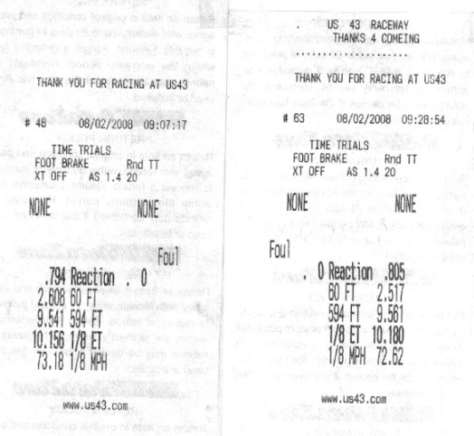

And I ran slower than I did before I did my head/cam swap! I was very disappointed. This was at an 1/8th track, before the best I ran was 10.07, then this weekend I couldn't do better than a 10.16. My problem was traction I figured because my 60s were about .4 slower, which I was spinning more but I figured that I could have picked up a little more the rest of the track. So now I'm looking for a set of DR's or slicks. Just wondering what size wheel and tire eveyone is runnin? And would this solve my problem?

with your setup you should be running in the 8's in the 1/8th. what were your 60ft times.

8s were what I was hoping to be able to reach, at first I thought I might be expecting to much. I didn't have any 60s under 2.5s this last visit.

post up a timeslip!

are you still on a mail order tune??

that TT2600 stall isnt helping you much niether, TR222/221 554/554-112 <-- cam specs i would have went alittle bigger specially on the lift somewhere around 563, specially with those prc 2.5 heads, but thats just me, i would be looking for a stall around 3200

The first was my best ET, the second my best 60ft for the weekend.
I reckon I am, I can get one from nelson anytime
