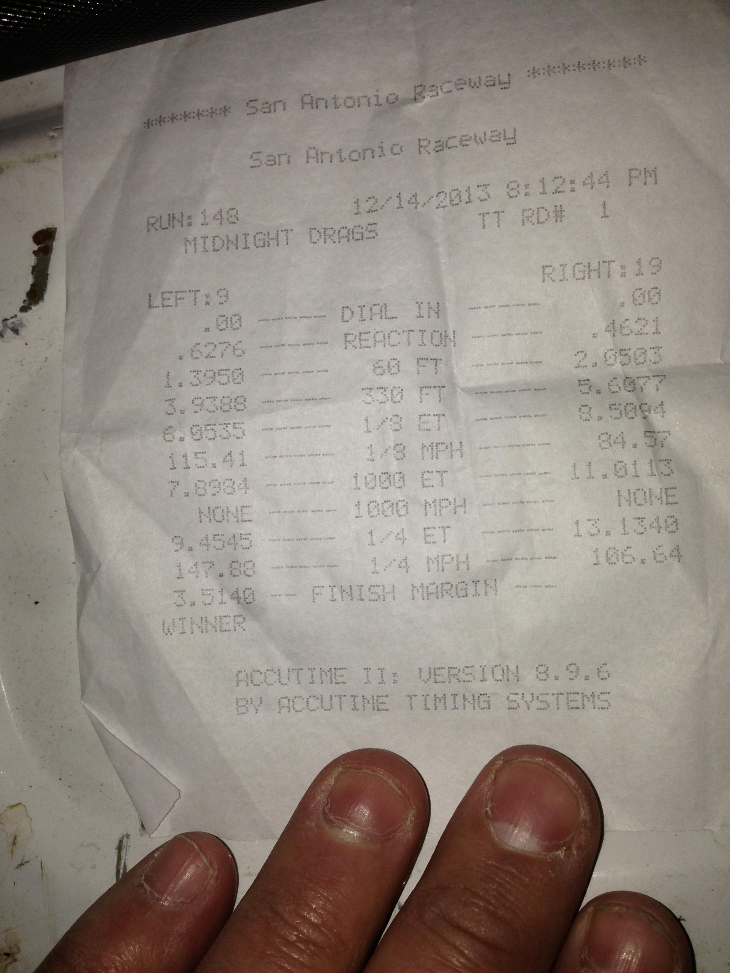

bump. lol
Maybe I should start a new thread.

Awesome! Glad to see you got to make a full pass and a damn good one @ that! Have a video for us?
Yeah may be a good idea. You will get more volume with a new thread lol

Sweet, nice .60.
