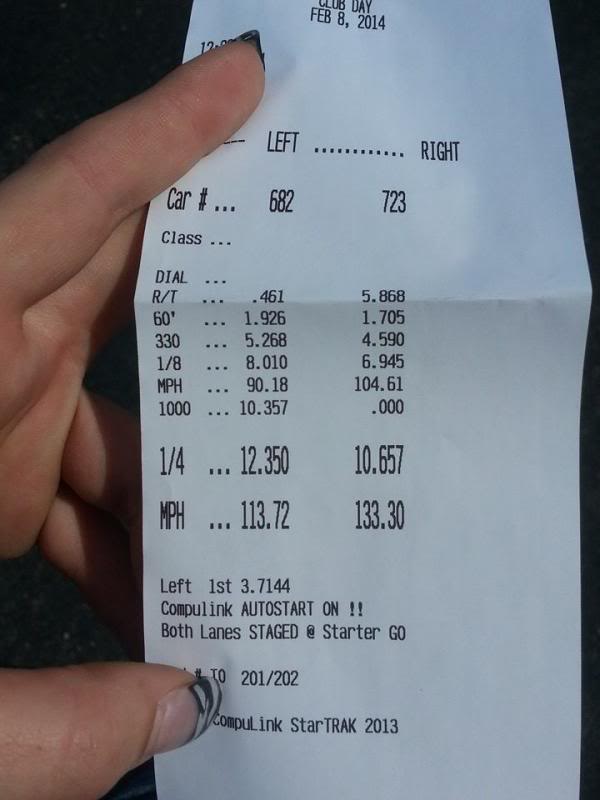

went from a single S475 cast wheel 83mm turbine 1.10 AR to a S480 double batmowheel 87mm turbine, 1.10 AR and hit the track to compare times.
Same fuel/nitrous.
On motor it gained .3 and 3.5mph.
on spray it gained .3 and 5.5 mph.
Here's some videos. Truck went 10.88, 10.72, and 10.65 from 131-133.3mph... nitrous jet was .070 from a dig.

10.65
10.65 @ 133mph duramax lb7 hondarider522 - YouTube

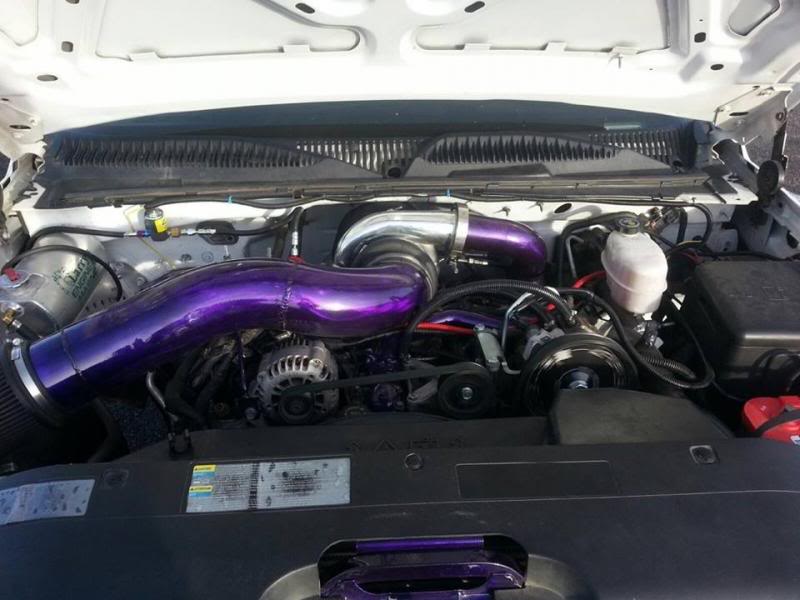

I am honestly not sure. I didn't buy this turbo new, I couldn't pass up the deal so I traded my 75mm plus some cash for this guy.
Here she is all settled in...

Nice times, and nice finger nails.

Whats the double batmowheel? Is that one of the single sequential turbos?

Id say he got the gains from going to a bigger charger. Tons of people have done testing with the batmowheels and some say its BS others swear by it.

Thats a really good back half mph gain!

Killer times!
I also love your nails. Haha

Yeah, the bigger turbo is what brought the extra power. Borg Warner tested the batmowheel and came up like 5lb/min short of their cast 80. Nonetheless, it still moves more air than the 75mm.
