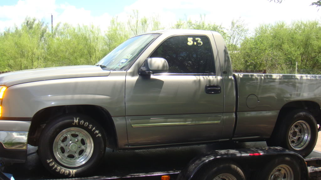

What tire and what size?

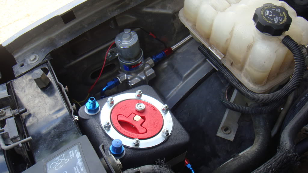

The truck was on Bogarts front and rear the rear wheel are 15x11 with a 29.5 x11.5 mickey thompson ET Drag

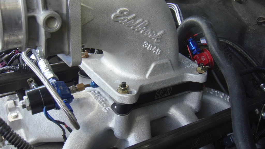

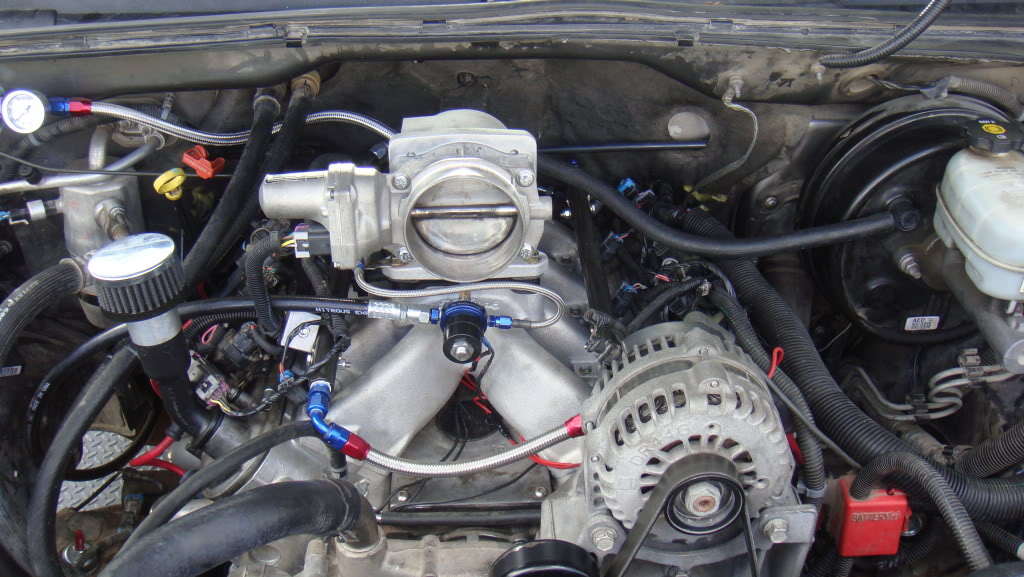

I'd like to see a picture of the vic jr setup.
Here u go:

Was the Edelbrock 90elbow designed for that throttle body or did you drill and tap the holes?
No drilling required they fit perfect.

Cool! does this throttle body work in place of the truck throttle body (electric also) without mods to the ecm?
no u need to get an DRX adapter to make it work. I don't know if they are sponsors here. Its a plug and play little box im not sure if u can see it there in the pic.
