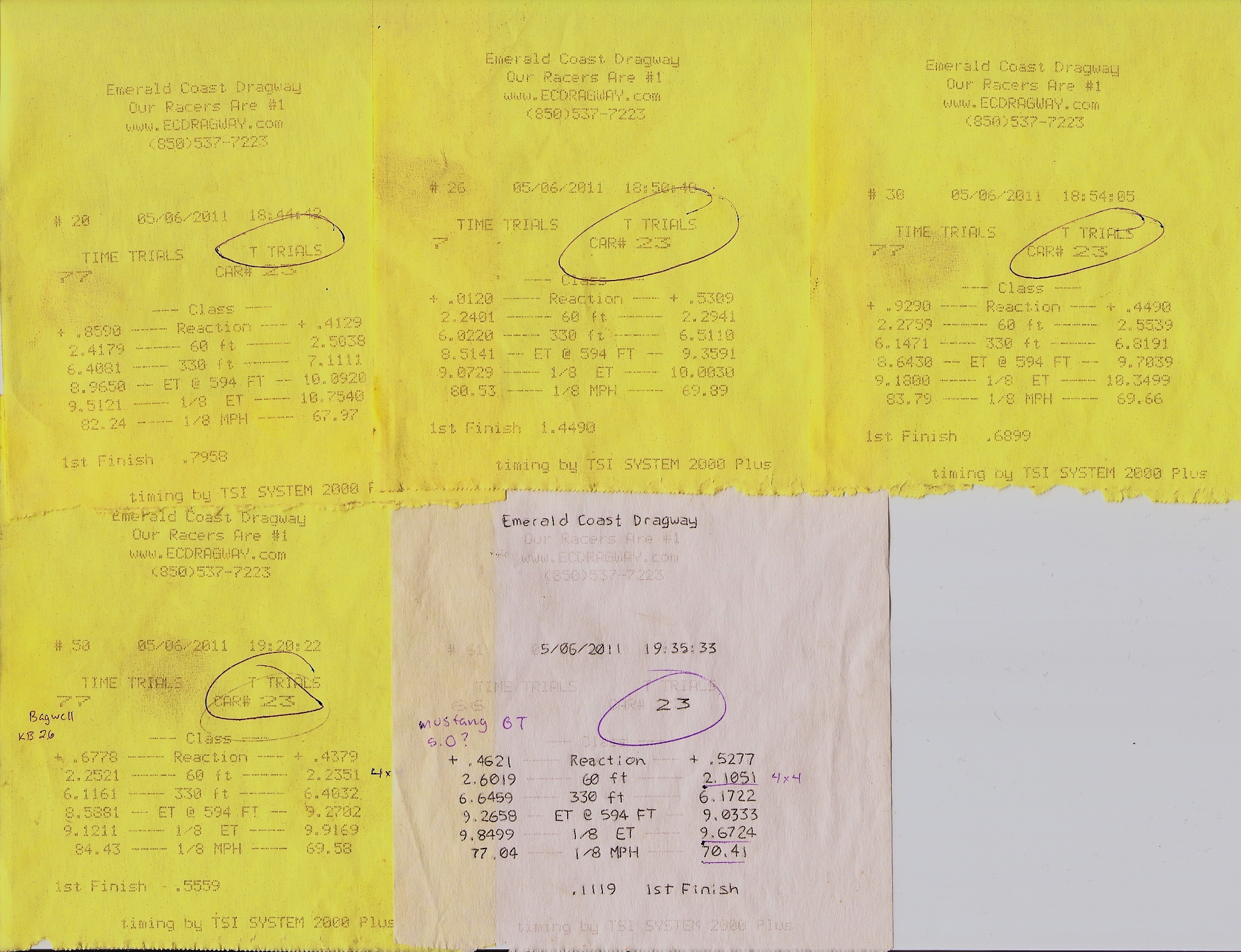

launching in 2nd will really take some slipping. i've got 4.30s with my 33" tires (a little lower-geared than stock 245s with 3.73s), and i've got to slip it a little starting in 2nd if i'm at a dead stop in normal driving.
as for an A->B comparison between 2wd & 4wd launches, here's the last time i ran the truck (yeah, forever ago):
the last 2 runs were in 4wd & saved me a best of .2 on the launch, .3 on the ET, and .5mph. this was with a stock long block 5.3, LTs, ORY, Blackbear 91 scan tune, 3.73s, and 31" highway tires.
